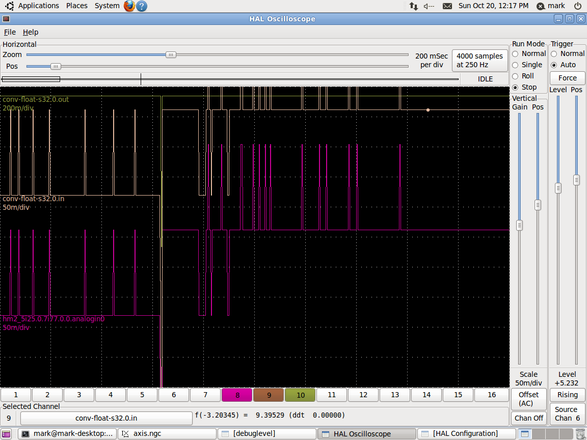

21 Oct 2013 05:05 #40107
by kramdradoow
Replied by kramdradoow on topic Bridgeport Retrofit - keyboard input delays noted
I did a little work this morning before the football games started. I attempted to isolate the random events easily identifiable using the debug task function (Issuing EMC_TRAJ_SET_SPINDLE_SCALE -- (+233,+20,+101413,0.933600,) with no adjustment made to spindle override. I get the same type of error message indicating adjustment seen by a mysterious feed rate adjustment too. I just didn't copy that line for this post.
Thinking I may have a electrical problem such as noise or ps ripple I ultimately used a ripple/noise free device, a 9V battery as the input to the mesa 7i77 board. There. No possible ripple or noise coming from that battery. Any change in feed or spindle rates must be coming from something else.
I noticed the randomly generated debug messages and finally captured an event on the halscope. The attached screen capture is with the a 9V battery tied to the 7i77, TB7, pin 1 and 2 , the first 2 analog input pins when using Mode 2. I am using Mode 2 using this in my pncconf generated hal file. loadrt hm2_pci config=" num_encoders=3 num_pwmgens=0 num_3pwmgens=0 num_stepgens=0 sserial_port_0=10000000 "
So with a steady ripple free input I have some unexplained events occurring.
Attached is the new code handling the feed and spindle override functions.
It is puzzling how with a solid input to the 7i77 I can still see the 150mV transients and the occasional ~300mV one as you can see from the scope trace. Its the 300mV one that caused the output of the float->s32 converter to transition from 9-8 and back to 9 which triggered an error message related to feed change that I saw on the debugger.
Am I all wet? Any ideas?
Mark

21 Oct 2013 05:56 #40110
by gmouer
Replied by gmouer on topic Bridgeport Retrofit - keyboard input delays noted
Ok, as I look over the halscope plot, with a 9V battery supplying the analog signal to the mesa 7i77 board input and the hm2 analog output from the mesa board loaded with spikes, I can only assume this is MESA related and something PCW / Pete would be the man to look this data over.
The spikes are surely not on the 9v battery but are on the output of the mesa board. Sounds like the spikes are being generated / added by the mesa board to me.
George
