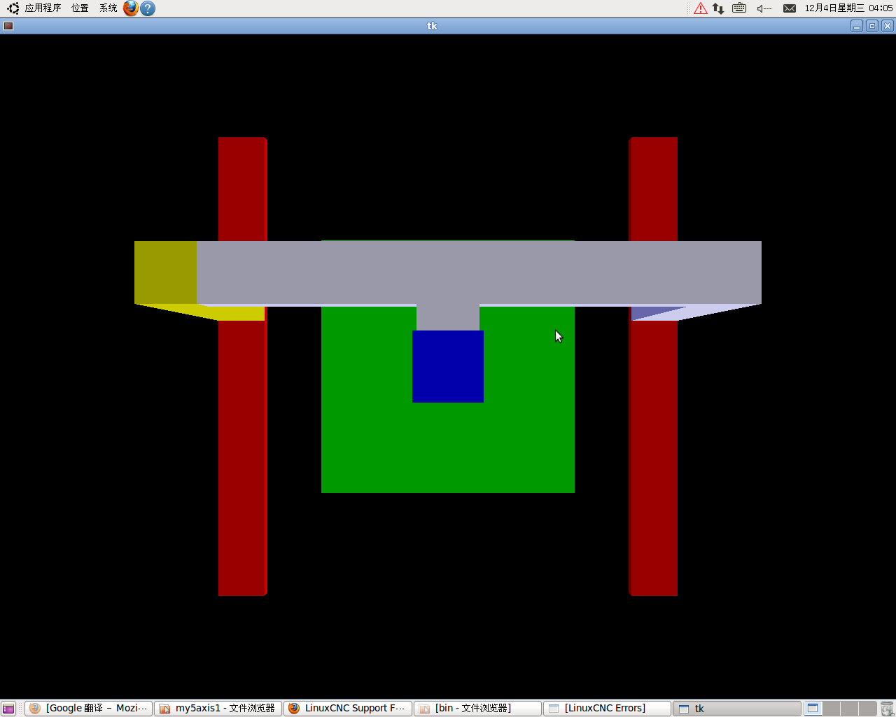

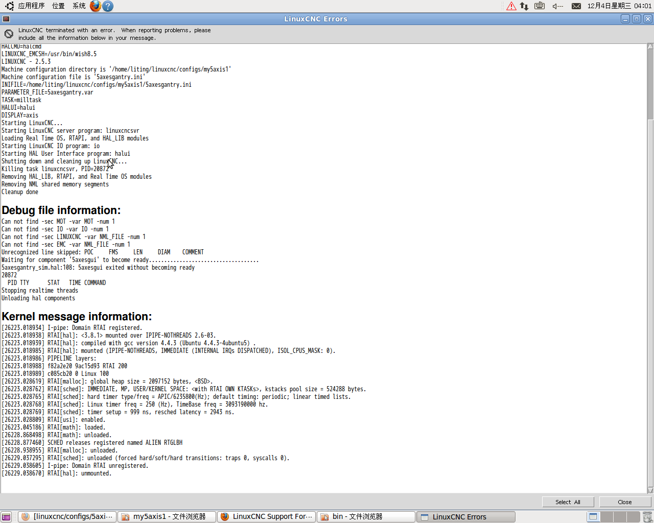

I run my mill ,but it only show the gantry map, when I quit ,it told me the error
I confused , anybody could help me ?

unrecognised line in your tooltable , or poor formating
check line 108 in your sim hal file , it probably relates to the tooltable entry

I have check it ,but the 108 is very simple ,I have put the .hal file on attachments. would you mind help find what's wrong with it?

It looks like a typo between 5axisgui and 5axesgui
Replied by andypugh on topic 5axesgui exited without becoming ready?
thank for your reply;
loadusr -W 5axesgui
net j0 axis.0.joint-pos-fb 5axisgui.joint0
