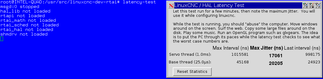

Hi
If you run latency-test from a terminal, this is what you get
You will get the same if you use halrun
Can you run the axis_mm sim from /configs/sim/axis/ in the RIP tree?
The output you should get is
