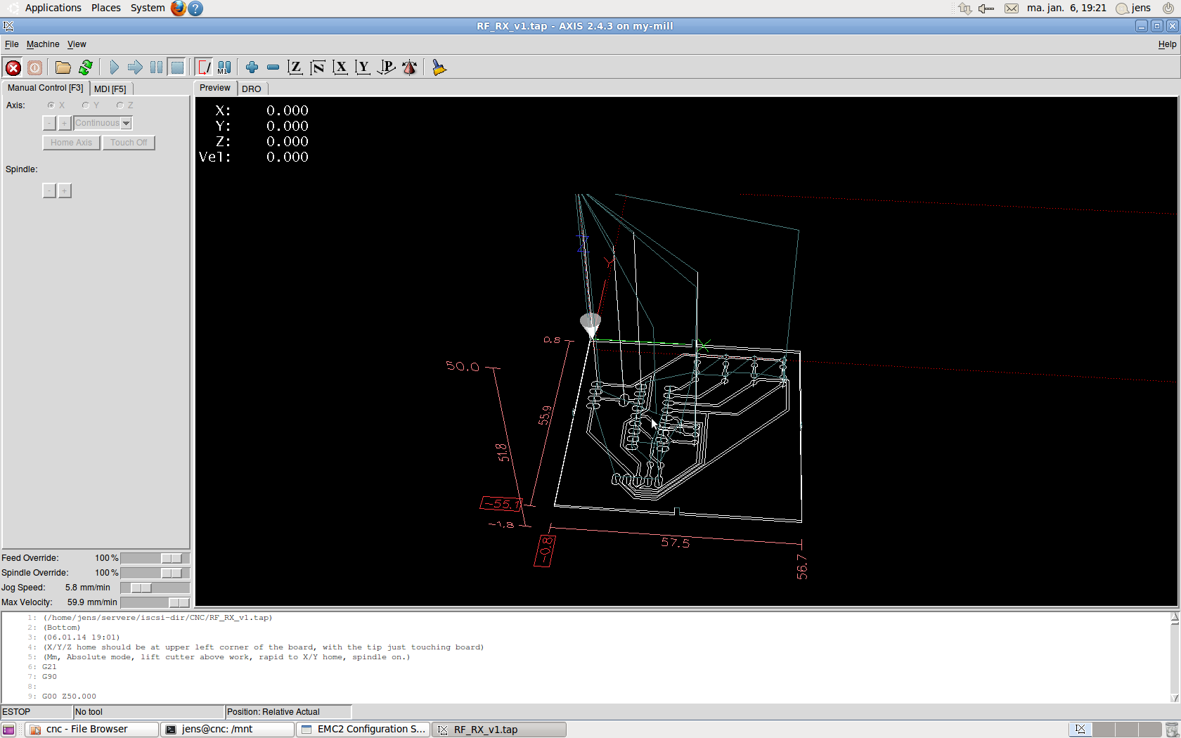

Negative Y - axis was created by nerdegutta

Most probably you defined the zero in Eagle to be where it is shown in Linuxcnc.
The most simple is to generate the gcode again with the zero position in the lower corner (or you could apply an offset and define in linuxcnc another zero with G54 and so on - wiki.linuxcnc.org/cgi-bin/wiki.pl?CoordinateSystems).

I don't think there is an option in gcode_02.ulp to define zero. In the *.tap file is says that zero should be in the upper left coner.
Thanks, I'll give it a try.

Neither of those options worked. I've tried 2 different *.ulps and several boards.
Any other suggestions?

If all your code will have the Y negative, then define on your machine to be on X0 Y0 in the upper corner, like the board.
This is easily obtained by using a coordinate system, like G54 (you can define the X=0 Y=0 where you wanted to be)

This is probably not actually a problem. Does the board look to be OK, and not mirrored?
If so, ignore the numbers, jog to the top-left corner touch-of X Y and Z to 0,0,0 and run the code.
G-code nearly always runs in -Z, and often in -Y too. -X is less common for some reason, but still isn't actually wrong.
Replied by andypugh on topic Negative Y - axis
I've made a PCB layout in Eagle and run gcode_02.ulp. When I load the board in Linuxcnc, the board is laying on the negative side of the Y-axis,
