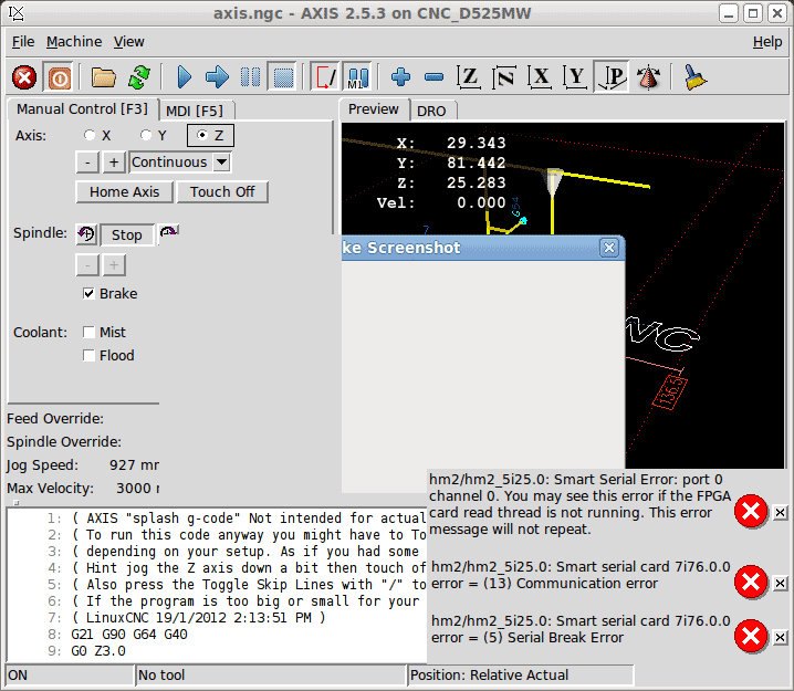

I got smart serial error (mesa 5i25 w/7i76) was created by b2unit
2 or 3 hours have passed after turnig on pc
my system got smart serial error. I attatched screenshot.
I don't know what this mean, why this happen and how to fix it...
please advice me
my system is
D525MW w/4g memory
5i25 & 7i76 installed
linux version: 10.04
linuxcnc version: 2.5.3
when I got those error messages just close alert window and check each axis motion it looks ok.

Those errors indicate that serial communication was interrupted somehow
The Break Error especially indicates something major wrong with communications.
this could be a bad cable connection, bad cards, or more likely a power supply issue.
Other possibilities are external noise induced by routing power cables near the 7I76/5I25 cable.
I would first check the 5V power at the 7I76 and field power at the 7I76 to make sure they are
within specifications.

I checked the 5v power at the 7i76 and field power at the 7i76 both are within normal range.
and I changed the cable till now no error message. but this error message is randomly appeared so need to watch for long time..
