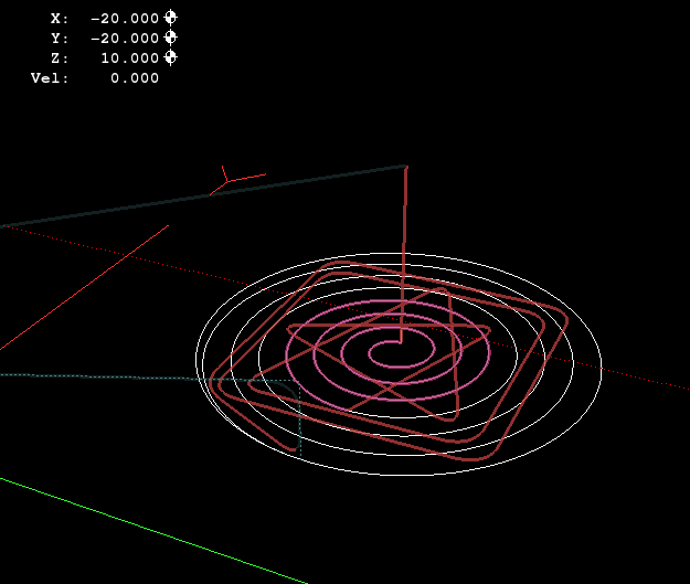

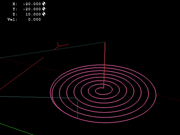

The gcode below cuts a circular recess into a flat surface.
It is not anything like what you are doing, but I chose it because the effect of path blending is very stark when talking about circles.
Half way through the code I changed the path mode to G64 P0.002 (it is imperial code)
The resultant plot is as normal, hard to see if the path mode changed
Change the mode to G64 P0.2 and you can see it definately did change, it is so far off the path, it cuts triangles and squares
(I assume you are using metric, as I normally do, so P0.2 is quite a reasonable value , rather than 2/10s of an inch which this represents
So changing mode within your gcode works fine and that is the best way to do it.
A MDI command will fail if Linuxcnc is in AUTO or MANUAL mode.
As I said there are ways to pause and drop out of auto mode do something, go back to auto mode and resume, but that is quite an advanced programming subject.
What you want to do can be easily achieved by inserting path mode changes at relevant roughing out sections and reverting to G61 when doing the finishing stuff.
regards

G28
M2
regards
