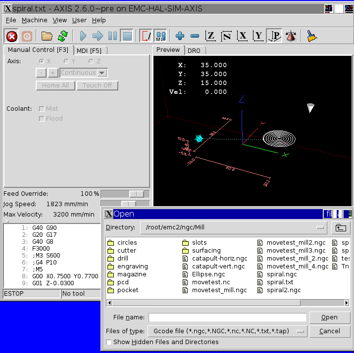

I would like to have the nc_files location on the root directory of my Ubuntu machine. Will LinuxCNC still work and allow this? I would also like Linuxcnc to run programs with the .txt,.ngc,.pu,.nc file extensions can this be added also?

PROGRAM_PREFIX=

A G code file can have any extension at all but it still must be a LinuxCNC compatible G code format.

Will this work, I want to open bascially any file type.

Try it, if you don't want to mess up your own config, try editing one of the sim config ini files.
It should do, you will just have to change the file type to any file in the file selecting dialog, or you won't see them.

Hi
Now back in front of a linux machine
Your entry would not have worked, largely because you have the entry 'gcode file' where in fact there should be an executable which is used to load that file.
You could use /usr/bin/axis but that is unnecessary because all files are loaded by axis, it is just that some require the output from another file to be loaded and not the file itself, eg image-to-gcode
This is the optimal entry
You can add any file extensions to the list in the comma seperated fashion shown
Listing them produces a menu entry on the file chooser dialog, so that files with those extensions are visible
Note the pic below lists the same extensions as my list and that the file loaded is actually a .txt file
regards
[FILTER]
PROGRAM_EXTENSION = .png,.gif,.jpg Grayscale Depth Image
PROGRAM_EXTENSION = .ngc,.NGC,.nc,.NC,.txt,.tap Gcode file
png = image-to-gcode
gif = image-to-gcode
jpg = image-to-gcode
dxf = image-to-gcode
py = python
regards
