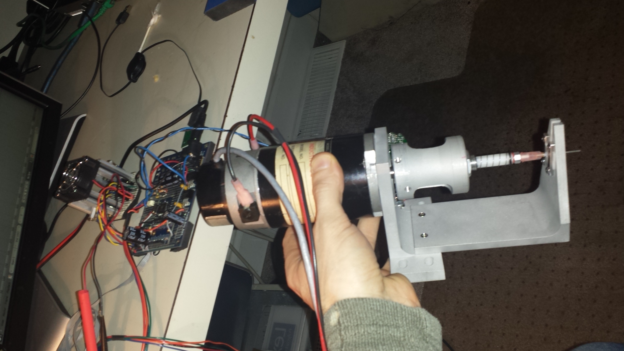

I have begun building a servo motor controller of my own flavor using a P8X32A microcontroller and an EG&G servo/encoder. so far i am successfully reading in the encoder and have started working on the h-bridge.
i hope to soon incorporate this into linuxcnc and I truly appreciate all of your input!!

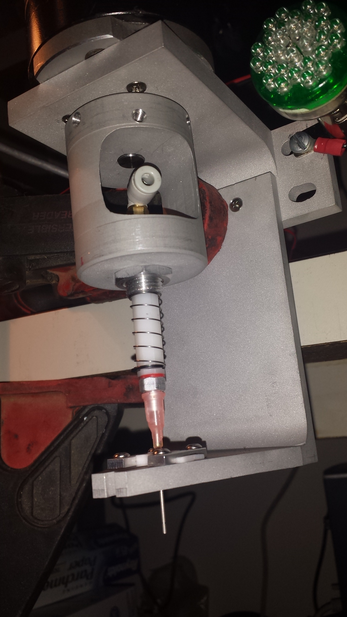

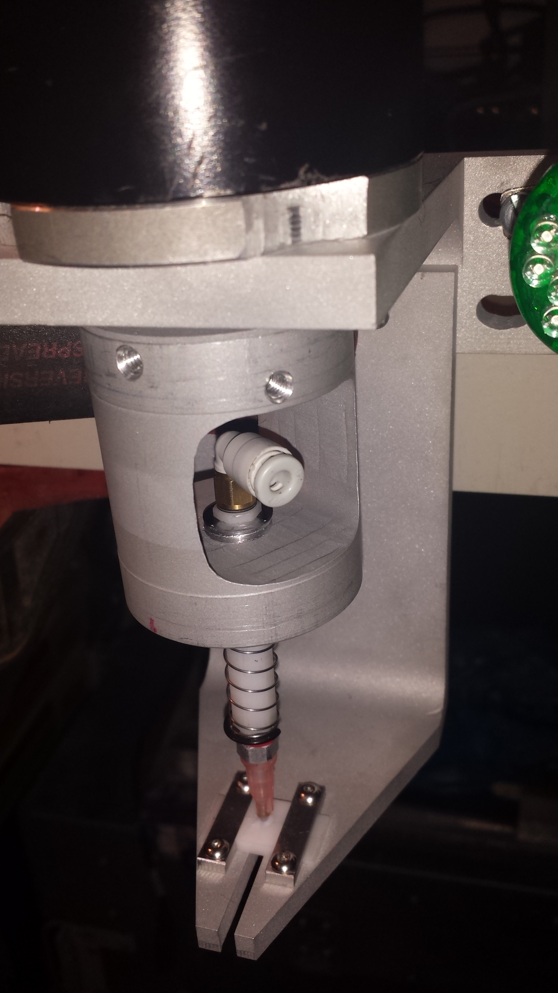

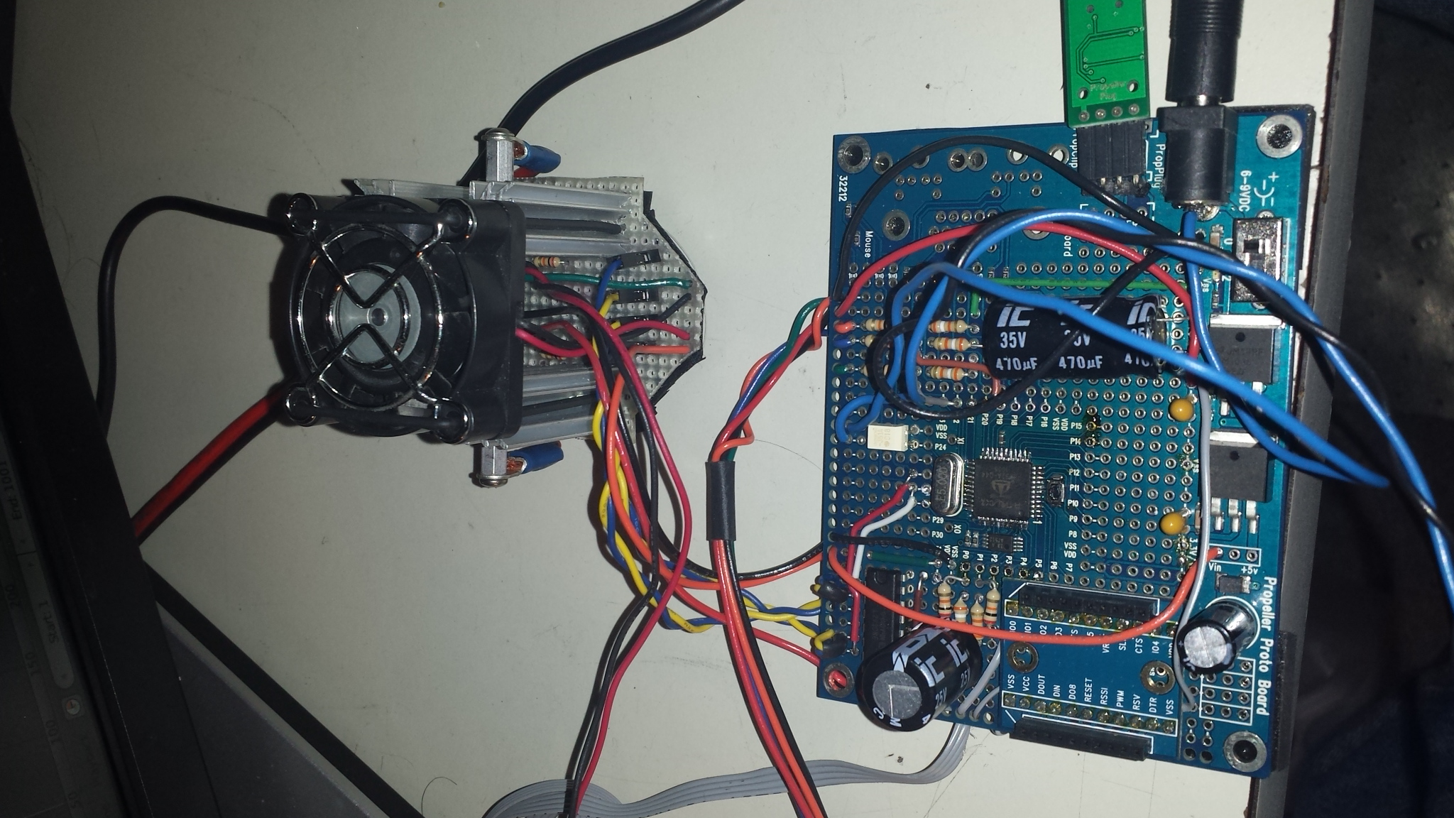

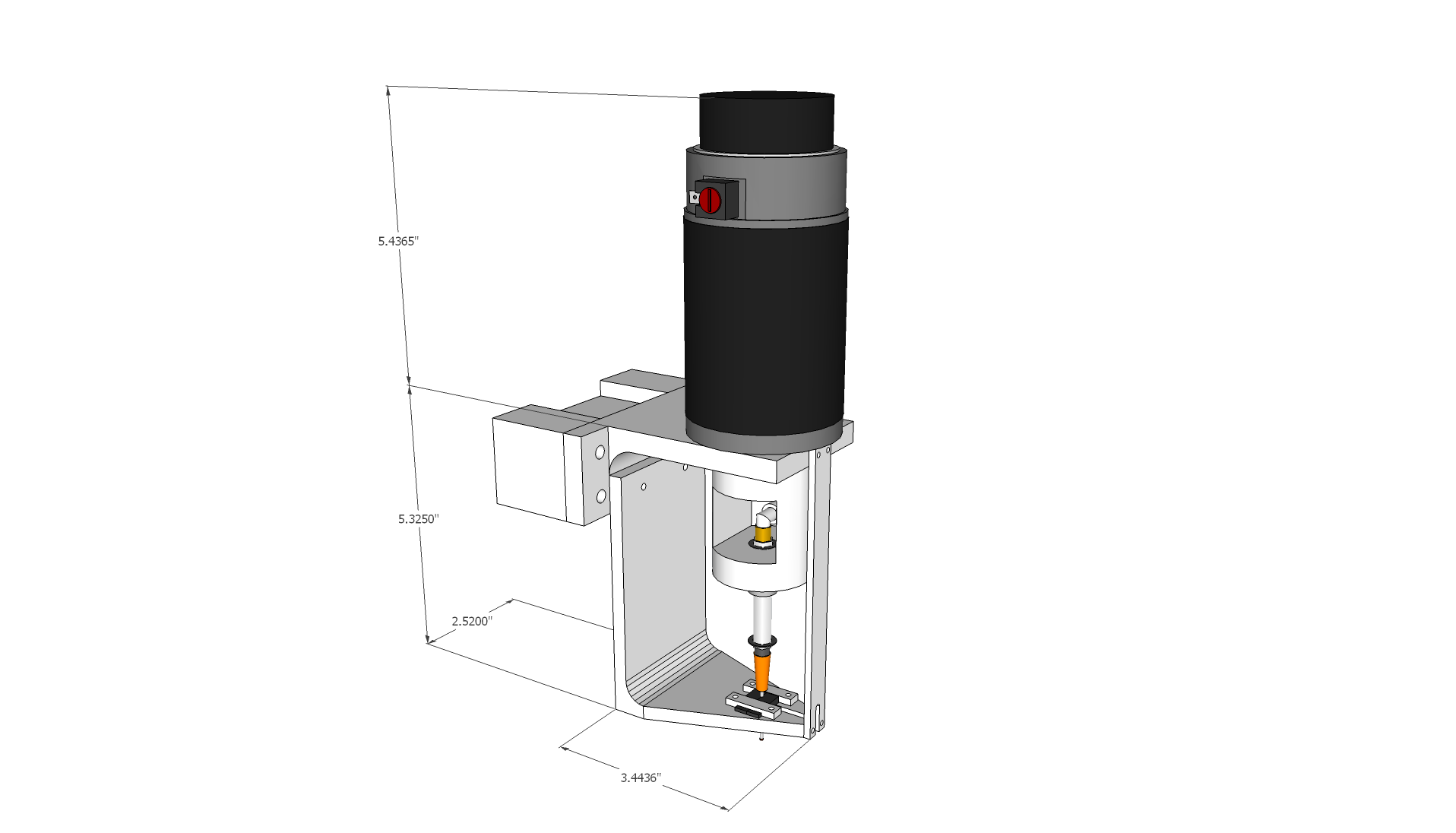

I have finished the servo motor controller and the pick and place head.
I thought i would share some images and videos as all of you have been so helpful!!
This is the design i made of the pick head its self
And an image of the overall system (including the servo, pick head, homemade h-bridge driver and one Parallax propeller proto board)
Close up of the driver
A close up of the pick head
and a closeup of the rotating needle
This is a video of the head in operation, it is currently being controled via the serial RS232 port and a simple command set i developed. the sequencer is actually a Python script running on a PC.
