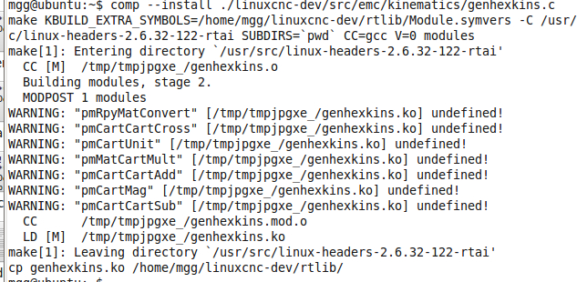

Hi everyone
I tried to recompiling a new HAL component with 'sudo comp --install genhexkins.c'
It always wrong
the error is shown in attachment
hw could I solve it?
Thank you ~~~

genhexkins.c is not a standalone component that comp understands, it is an integral part of the kinematics in Lcnc
1) Provide all the correct headers and libraries when you build it, which is not simple with comp.
2) A far more sane approach, is to substitute your new one for the old one in the source tree, and build Lcnc
regards

Unfortunately you can only successfully compile/install kinematics modules with "comp" if they don't #include any external files (other than normal maths libraries)
You will have to recompile all of LinuxCNC to recompile genhexkins. Well, actually it would be possible to only recompile genhexkins, and that is what will happen if that is all that has changed since the last compile, but it is less work to run "make" rather than manually compile just the one file.

I 'make ' a new linuxcnc-dev;
it's the same error;
what was wired is other component such as 5axiskins ....is ok~
only for genhexkins.c or genserkins.c
all headers is included.
what shoud I do?
thanks
what shoud I do?
thanks

i 'make' all 'linuxcnc-dev' is ok~
but when I tried to 'halrun->loadrt genhexkins' ,the same error is shown~~

The error is because you have built a kernel module without functions it uses being linked against it.
Off the top of my head, these look like cartesian maths functions and the pm prefix could well mean they should be found in libposemath.
Without sight of the whole source tree with all your changes, it is impossible to guess what might be causing this.
If you want to stick the entire source code tree into a github repo and let us know the url, we can look at it further, but otherwise we are working in the dark

Thank you for your help!
It has been solved~
I really 'make ' the whole 'linuxcnc-dev', but my 'halrun' was executed without 'rip-environment'.
so ,after '. ./scripts/rip-environment'
halrun
loadrt genhexkins
everything is ok~~
regards~
