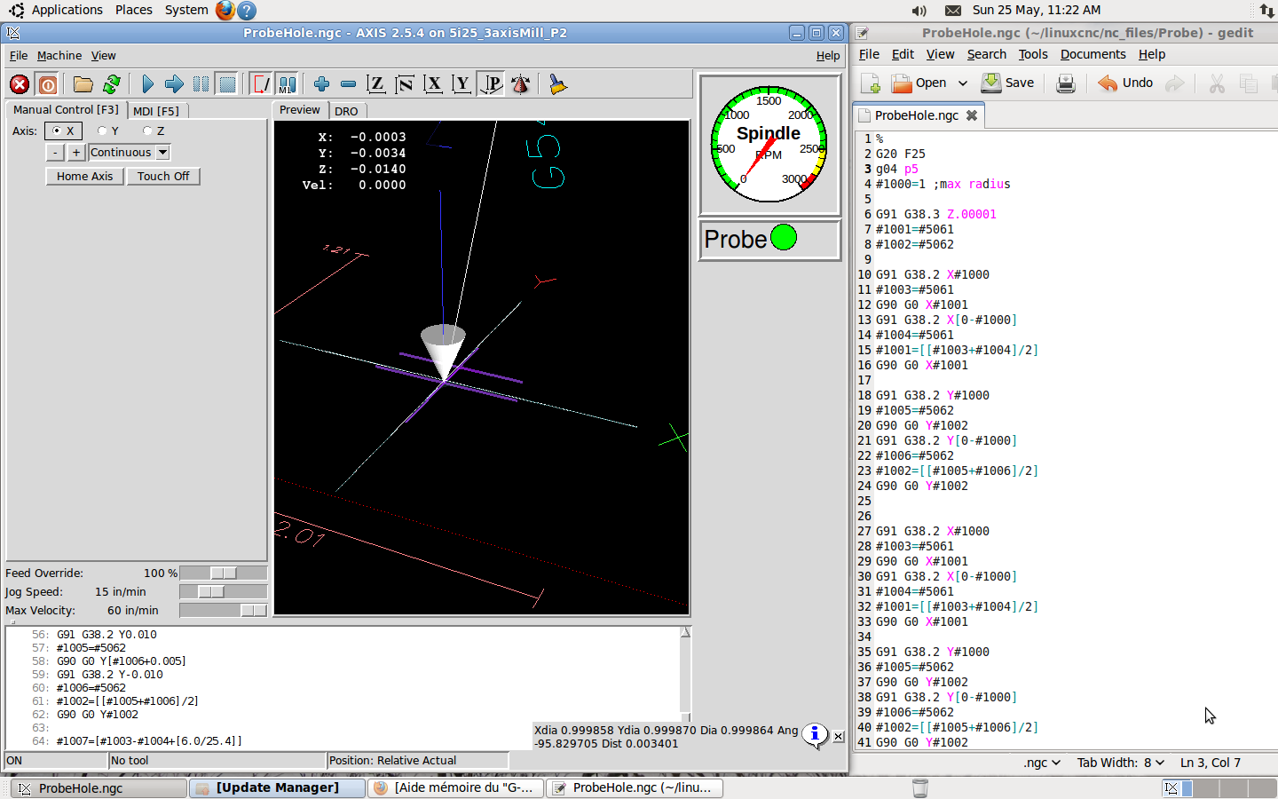

I use a home made conductive probe. The tip is a ball bearing held in place by a magnet.
Here is a screenshot and video of hole centre finding with LinuxCNC, using a program posted by cradek ( 01262579508 ).
The probe works well for edge finding on metal but is not good for height. Here's an example of a non conductive probe that will probe edges and height. There are many examples out there of people who have made their own.
