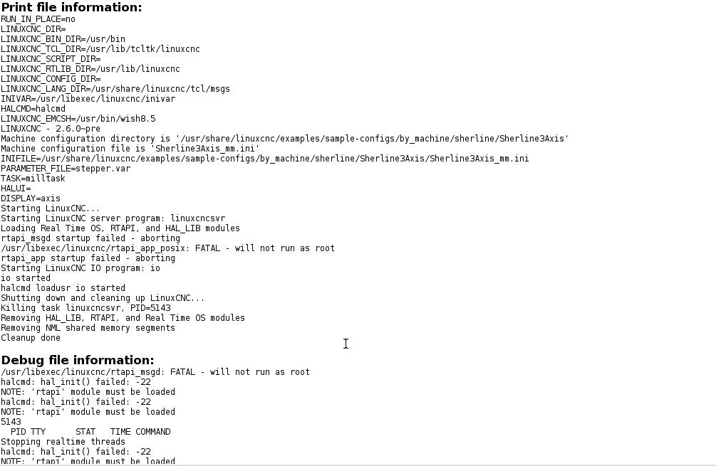

I have installed linuxcnc on my raspberry flowing these steps described in this
link
so when start the linuxcnc I got the error shown in the attached picture.
thanks

You seem to be trying to use posix threads, and that isn't supported by LinuxCNC.
You probably want Machinekit.

Hopefully you have downloaded the correct deb for the xenomai kernel.
The error is simply because you are trying to run it as root, it says so twice in the first screen capture. (FATAL - will not run as root)
Michael wrote a test in to prevent it running as root in the early days of ubc.
I could tell you how to circumvent it, but then I would have to kill you
regards
