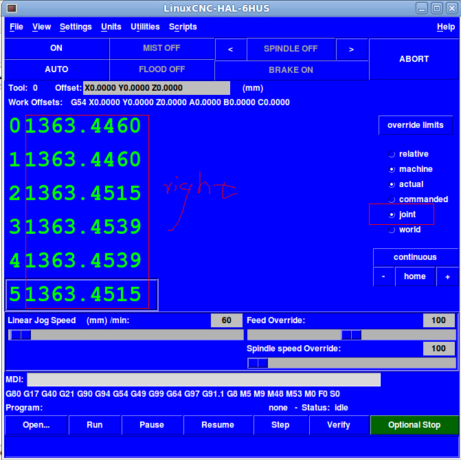

hello,
I meet a problem about kinematics;
there is a kinematic component about my machine, it's ok be loaded in my hal;
it can calculate correctly in joint mode,such as:
but in word mode, there isn't values, I could not find some thing wrong, hope anyone help me.
my kinematics component files was atteched: 6HUS.c and 6HUS.h

Replied by andypugh on topic kinemactics-- compute wrong??why??
Just a guess, but your EXPORT_SYMBOL lines are inside an #ifdef, I wonder if they are actually being exported properly?

thank for your reply~
I finally find the error exited in kinematics....
