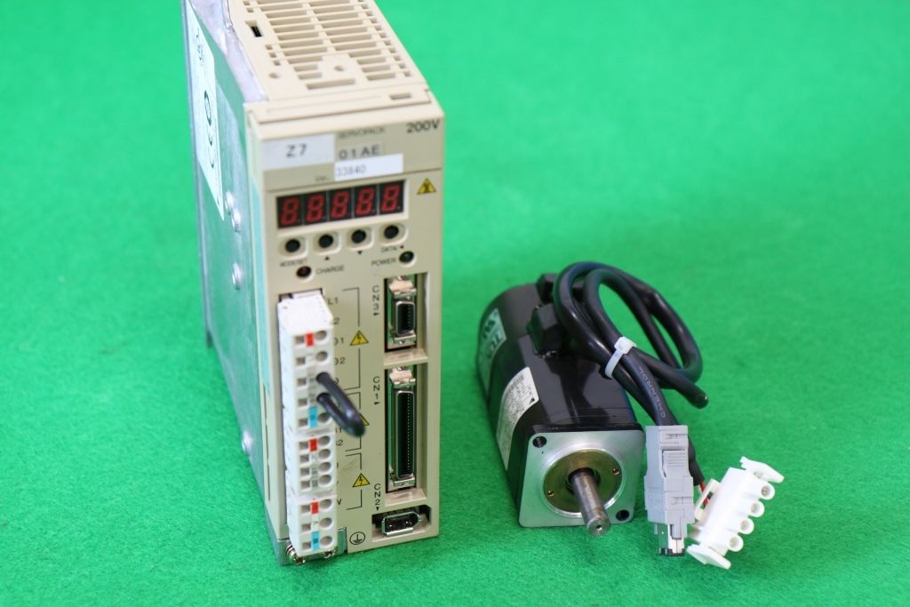

I am trying to put together a 'portable' test setup using 4 200V 100W Sigma II Yaskawa amps and servos. I want to drive the the setup using just my PC and it looks like using LinuxCNC is probably the fastest way to get there. Any help on wiring diagrams would be great. Can I drive the amps/servos using only the CN3 connection to my PC? I.e. can I ignore the CN1 connectors?
I have 4 SGDH-01AE amps and 4 SGMAH-01AAA21. Will I need to also get 4 Magnetic Contactors to control the power to the servos from the amps? Any help would be appreciated. I am an experience software developer and I have worked on embedded controls, but I am new to CNC amps/servos.

Can you please post links to pdf ? I just went through two of those and one was for 22KW and higher and the other was for linear motors that can be controlled by them !
That with linear motors got me thinking...... how hard would it be to make one ? I have some ideas, but not time.

I've used these motors and drives on a few machines. Easiest to use mesa 5i25/7i77.
Works like a charm. encoders into 7i77, velocity, speed ref +-10v, 7i77. Doesnt get easier than that.
These are work horses and pretty easy to setup. You cant break them.
/EDIT Try to get the little operator 1.5" square module if it down't have it built in, that way you can change settings on the drive if it is not setup as velocity.
You only need one, can connect to each with one.
Get the wiring manual from Yaskawa site.
Bob
Bob

For a simple demo / testing config it probably makes more sense to use step/dir control and the parallel port. (If you have a parallel port, if not then it generally makes more sense to buy a 5i25 than to buy a "real" parallel port.)
