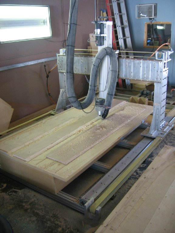

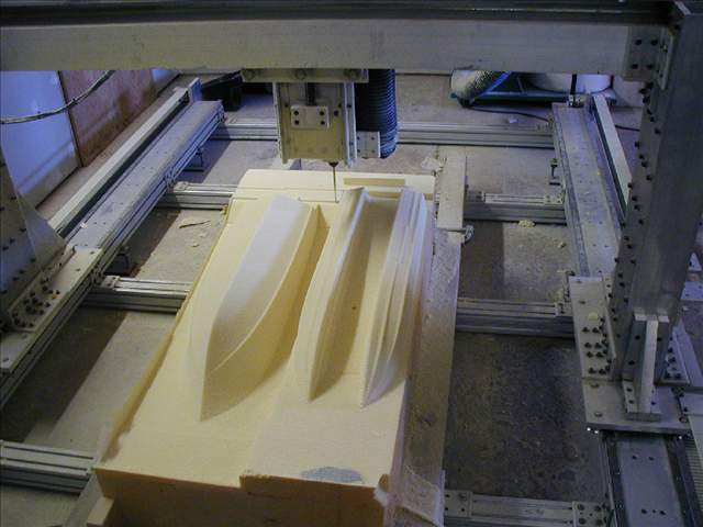

Well, I'm going to order the mesa cards next week. I want to thank everyone for the input. Any suggestions on a new pc are welcome. A few pics of the machine are attached. I'd like to make it a 5-axis at some point with a rotary axis at the router and a "double-x" axis that allows me to machine parts that are longer Maybe 16 feet we'll see. Thanks alot.

You could consider a second gantry and having two sets of code running at the same time.
However... At the moment this would need to be two separate PCs and hardware, a single PC can only run one instance of LinuxCNC at any one time, and even though you could conceive of using UVW axes for the second gantry the system can only run one G-code file at a time.
In theory this means that a CAM system could arrange to break every move in UVW at the same time as an XYZ move finishes ans vice-versa, but there is no way to simply run an XYZ and a UVW G-code file in parallel. Which is a shame.

Interesting. I was thinking of a long high speed xtra x-axis table added to the existing bed since i have plenty of z-height. Then i could use the existing gantry basically as a moveable x-axis.........it would be able to change x-axis zero positions to get the extra length but it would stay still during machining. I would just have to set up two(multiple) cad files with different xzero positions...........am i making sense?

06 Sep 2014 05:05 #50823
it's not even that hard. Just have G54 as one position and G55 as the other and you can use the same X-numbers all the way through.
(you may need to split the files to stop an out-of-limits moan from the preview, or you can probably click "run anyway")
Replied by andypugh on topic linux compared to centroid and acromill
I would just have to set up two(multiple) cad files with different xzero positions...........am i making sense?=

Why not make a configuration that moves both the extra table and the gantry in proportion? Say you want to move the X 10mm. Then you could move the additional table 5mm and the gantry 5mm in the opposite direction.

In the end the LinuxCNC software package is just a bunch of Lego blocks that you can stick together anyway you like.
Normally you stick the 'stepgen' blocks directly onto the 'motion' block, but nobody prevents you from placing a few Lego blocks between the 'motion' block and 'stepgen' blocks that take the X coordinate, divide it in two, send the first half to the gantry 'stepgen', invert the second half, and send the inverted second half to the extra table 'stepgen'. That is the real beauty of LinuxCNC; you can make it work the way you want.
Of course it is not quite as simple as just splitting the coordinates in half; a few side issues need resolving if you decide to go this route. But don't let that scare you; things are never as simple as they initially appear. That was already true when you learnt to lace your shoes when you were a kid.
If you never ran LinuxCNC then of course this is above your head. Get it running first, get a bit comfortable with the system, build the table, and then implement this. Plenty of helpful folks over here.
