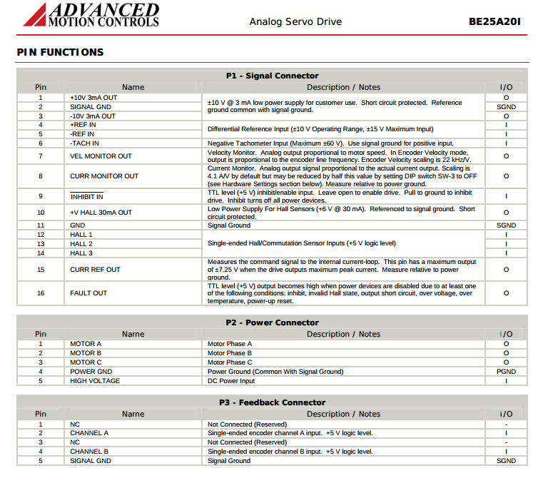

This topic is perfect timing and I have a few wiring questions, I have the AMC BE25A20 drives and I think that these drives would be wired as this?
drive pin 9 = /INH --> relay NC contact
drive pin 2 =GND--> relay COM contact
Also, in the hal config when we have:
# create a signal for the estop loopback
net estop-loop iocontrol.0.user-enable-out => iocontrol.0.emc-enable-in
iocontrol.0.user-enable-out refers to TB8 - pin 17 (Output 0) ??
So I'm guessing here but iocontrol.0.emc-enable-in TB8 - pin 1 (Input 0) is where we wire up the E-Stop circuit to signal that we have unlocked the E-Stop button? I am unsure what the diagram would look like, does E-Stop go to Ground/COM when it's closed or is a closed loop switch? If it's closed one end of the E-Stop goes to Input 0 and the other end goes where? I realize these are elementary questions, but I am learning and I believe this is the glue that puts it together.
My setup is the 7I80DB+7I77 running debian jessie (3.14.12 rt preempt kernel) on a Gigabyte J1800N-D2H motherboard.
Also, the relay that I planned on using are the Omron LY2-DC24 as I have several of them with the base.
Thanks for the help
Not unless you make it so. By default those HAL pins don't leave the software layer.
One way of wiring things is:
iocontrol.0.user-enable-out -> GPIO output pin -> main contactor relay -> ESOP11 -> ESTPO2 -> ESTOPN -> GPIO input pin -> iocontrol.0.emc-enable-in
(I practice the GPIO output pin probably doesn't have enough current capacity to drive the main contactor but can drive a solid-state relay quite well)
No GPIO pins are connected to anything unless specifically connected in the HAL file. You would need lines like
net estop-out iocontrol.0.user-enable-out => hm2_7i80.0.7i77.0.0.output-000
net estop-in hm2_7i80.0.7i77.0.0.input-000 => iocontrol.0.emc-enable-in
