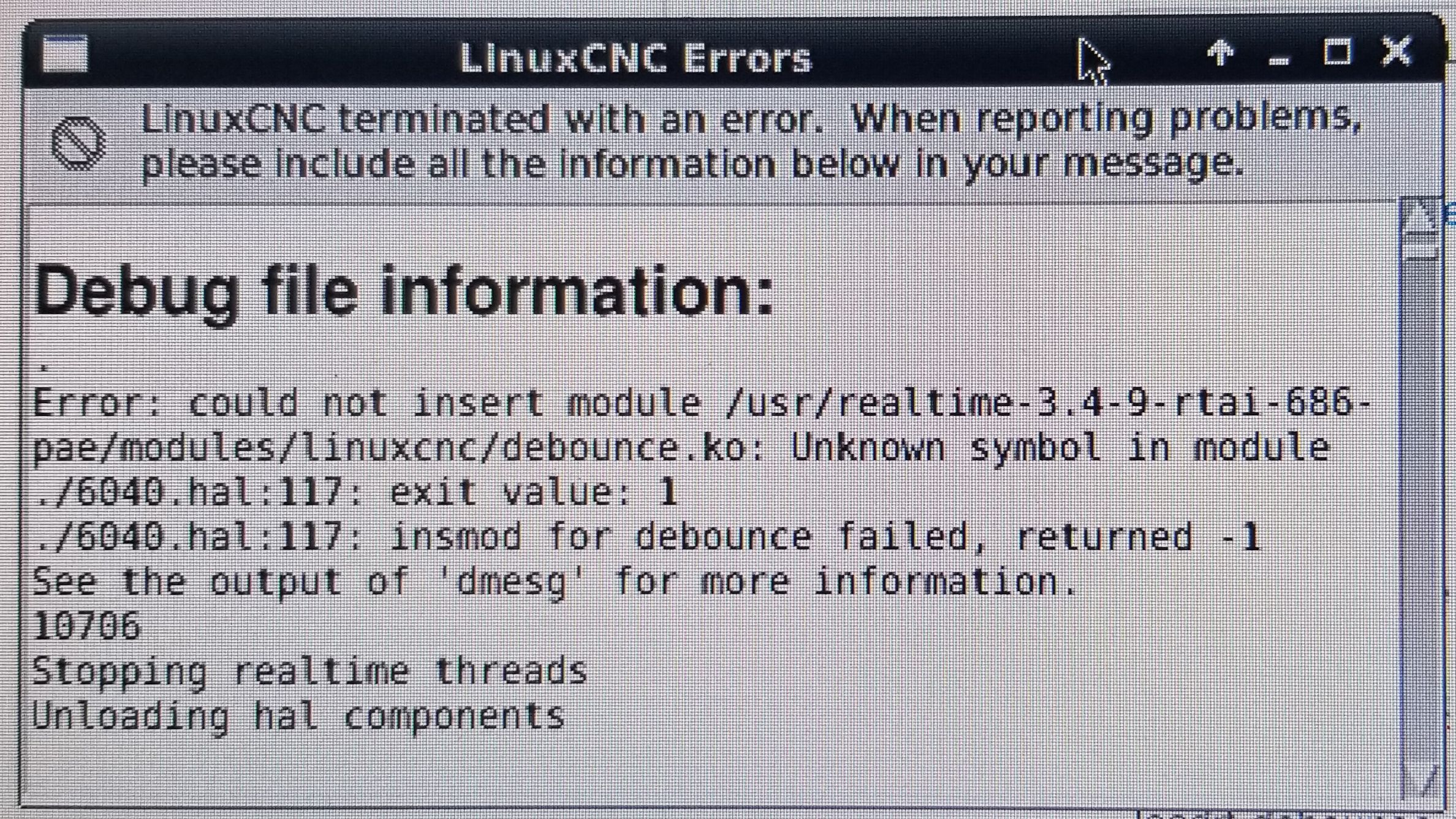

26 Apr 2020 22:10 - 26 Apr 2020 22:12 #165707 by jay.perez1
Replied by jay.perez1 on topic Limit Switch Troubles - HAL Debounce
Thanks Andy,
I added the code below to my HAL file and changed the Input to Pin #12 to match the pin on my BOB.
Launching LCNC fails now with the error message in the attached picture.
If you would please indulge me if possible by providing the exact code I need to cut and paste I'd really appreciate it.
Right now my goal is to get a simple 3 axis machine going with basic functionality so I can run LCNC to evaluate the machine's movement and the user interface for possible consideration for use on our Makerspace's 3 CNCs. If we decide to go farther we will be using something like the MESA boards and we will delve into the details of the HAL files at that time. (It will be a more talented member of our team doing that work to be sure ...) ;-)
Jay
loadrt debounce cgf=1,1 (This is line 117 in my HAL file.)
addf debounce.0 base-thread
setp debounce.0.time 20
addf debounce.1 base-thread
setp debounce.1.time 100
net limit_raw parport.0.pin-12-in => debounce.0.0.in
net limit_filt debounce.0.0.out
net limit_filt axis.0.neg−lim−sw−in axis.0.pos-lim-sw-in
net limit_filt axis.0.home-sw-in
net limit_filt axis.1.neg−lim−sw−in axis.1.pos-lim-sw-in
net limit_filt axis.1.home-sw-in
net limit_filt axis.2.neg−lim−sw−in axis.2.pos-lim-sw-in
net limit_filt axis.2.home-sw-in

26 Apr 2020 22:50 #165717 by andypugh
Replied by andypugh on topic Limit Switch Troubles - HAL Debounce
When that dialog box comes up you can copy the entire text and paste it in to a message here.
I tried that line 117 here to test.
Did you perhaps leave the old loadrt line there too?
26 Apr 2020 23:25 #165718 by jay.perez1
Hey Andy,
I hope you're talking about the window with the very, very long text string ...
I've also attached my HAL and INI files.
Didn't see debounce being loaded two times.
Jay

Debug file information:
Error: could not insert module /usr/realtime-3.4-9-rtai-686-pae/modules/linuxcnc/debounce.ko: Unknown symbol in module
./6040.hal:117: exit value: 1
./6040.hal:117: insmod for debounce failed, returned -1
See the output of 'dmesg' for more information.

26 Apr 2020 23:37 #165720 by PCW
Replied by PCW on topic Limit Switch Troubles - HAL Debounce
Typo in your hal file:
[196544.357752] debounce: Unknown parameter `cgf'
26 Apr 2020 23:43 - 26 Apr 2020 23:43 #165724 by jay.perez1
Plugging away at it Andy,
Looked through the error message and saw it didn't recognize 'cgf'. Took a chance and changed line 117 to 'cfg' because it sounded more like Configure and it now makes it past that error.
Now it says that setp on line 120 requires two parameters but only one given.
Last edit: 26 Apr 2020 23:43 by jay.perez1. Reason: Corrected spelling.
27 Apr 2020 00:07 #165725 by andypugh
My fault:
(But then, you ought to be looking at the documentation too!)
27 Apr 2020 00:08 #165726 by andypugh
Yes, that is because "setp" requires two parameters, but you only gave it one :-)
setp something value
I imagine you missed the value?
