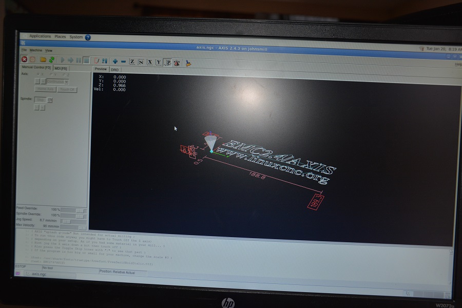

- Todd Zuercher
- Posts: 4993
- Thank you received: 1458
20 Jan 2015 11:36 #55198
Replied by Todd Zuercher on topic Moschip 9815CV
If you could attach a screen shot of the different "interfaces" you are talking about, I'm sure we could tell you how to get what you want on the newer version.
ie a picture of what you want, and one of what you are stuck with.

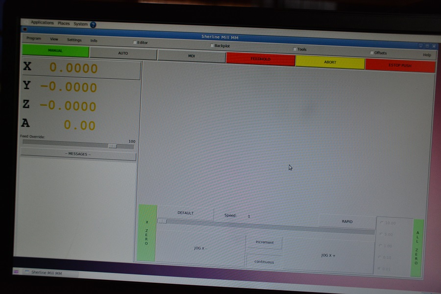

- Posts: 18567
- Thank you received: 5101
20 Jan 2015 11:43 #55199
Replied by PCW on topic Moschip 9815CV
This is expected since you have not changed EMC's port address in the
ini or hal file that EMC uses to run your machine.
The hal and ini file will be in your home directory:
cd ~/emc/configs/
should get you to the where the config files are stored but they may be in a subdirectory there

Thank you all for your replies. Let me tell you exactly what my deal is. I have a monster computer I built with about 2K worth of new hardware, graphics, i7, etc, nice machine. I'd like to use that for my mill. But the parallel port that I installed will not work with EMC2 interface. Now the reason I use EMC2 is b/c sherline told me that it's perfectly configured for their mill. I am open to doing anything I need to do in order to make this work with the newest software possible. I am also open to getting to know a newer system if it will perform better. I own a sherline 2010 8 direction mill. I will get some shots of the interfaces that I am speaking of and post them a little later.

Here are the pix, 1938 is EMC2, the one I use. 1939 is the other one that is created when I go into stepconfig wizard. 1939 is the one I do not want to use, 1938 is. The interface that is.
