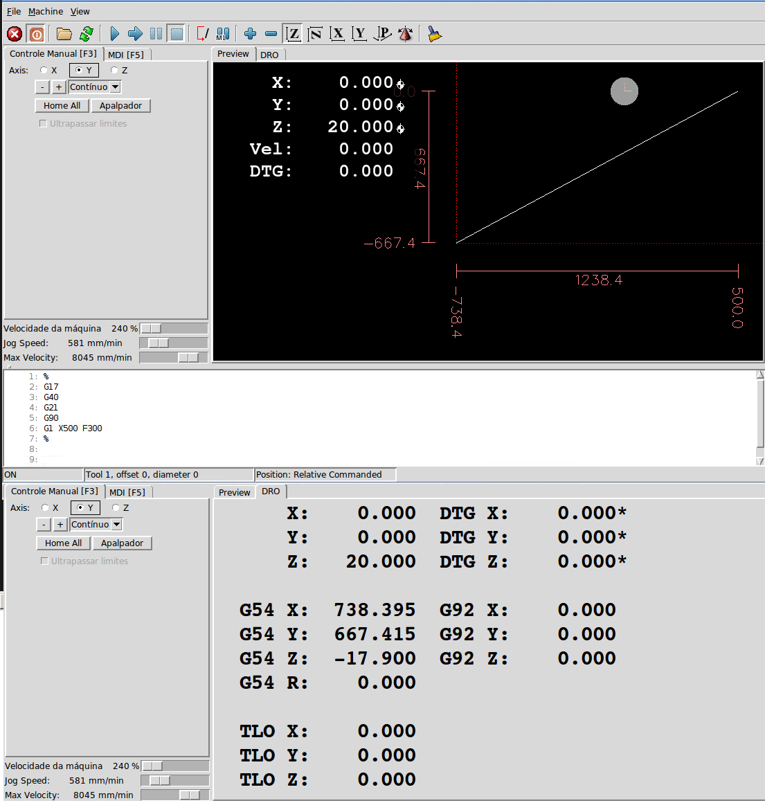

Hello to the forum.
I know that the version running the code is not the latest but the machine in question is far away from me, and the machine user does not have knowledge to update the system.
The machine is cutting ok in automatic mode, so I believe that this should be a simple question, but honestly I have been testing what I could remember using a remote desktop, but I was unable to solve/understand what is wrong.
The objective is just to move the machine in X to a determined place. The Gcode is very simple and it is on the screen shoot. I tested with G90 G91 and the result is always the same: Machine goes to X0Y0 without any command, where X0Y0 is the machine home position. Strangely or not, in MDI mode this does not happen, issuing the exact command. Damm I should understand this, but I am not getting there.
Any ideia? This is a bug that is currently solved, or what I am missing here?
https://drive.google.com/file/d/0B2x2WOxtQitRbUxJNThjZjRLXzQ/view?usp=sharing (see wrong diagonal line)
https://drive.google.com/file/d/0B2x2WOxtQitRVEV6V2d6XzU1Y00/view?usp=sharing
Thank you
Thank you

The X and Y bounds all come from the current G54 (see second attached link).
I homed, and touched off (before and after loading the program). Although I am not at my client workshop I did this remotely.
Strange is the fact that if I do this command in MDI mode, all works fine. ?!

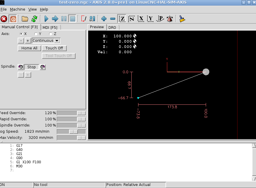

OK
I can see what you did and have replicated the touch off positions, albeit at only a 1/10th of the distance to save changing the soft limits on the sim
I touched off X at 73.839 and Y at 66.741 and changed the X move to 100 instead of 500 for the same reasons.
However when I run it it just does what you would expect, moves 100 on the X axis.
The diagonal line is the path to home from the end of the move, but I don't know why it is there, there is no corresponding G28 or whatever in the code.
Not much help I am afraid, it works OK here.
Have you tried the same locally on the same version?
regards
regards

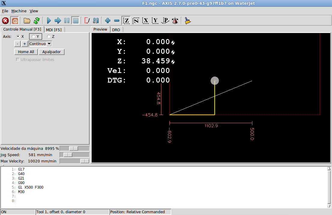

15 Jun 2015 23:54 #59858
by emcPT
Replied by emcPT on topic Error / issue on 2.7.0 pre
Just tested with version of 2.6 on a real machine with a similar set up as my client. Same happens in axis (the line goes up to X0Y0) but real machining does what is expected, this is, only the X moves from the actual position.
I will talk with my client, maybe the same happens there but since he sees the diagonal line he does not test the code with afraid of damaging his working part.
