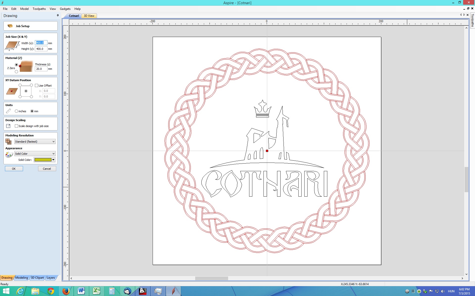

Hello!
I just started to work with LinuxCNC, and I already have a problem.
Hope someone can help me out.
The problem:
I have a circular barrel head to carve.
In Aspire I gave as the XY datum position the midpoint of the workpiece.
Everything goes fine, saved the toolpath ( with LinuxCNC postprocesor ).
But when loading the G code into LinuxCNC the middle of the workpiece is allways the left bottom corner of the table ( outside the table ).
If I home and touch off the X,Y and Z axis in the middle of the workpiece when the spindle starts to work it doesn't start from the middle of the circle where the touch off was set, but starts to jog somewhere right upwards.

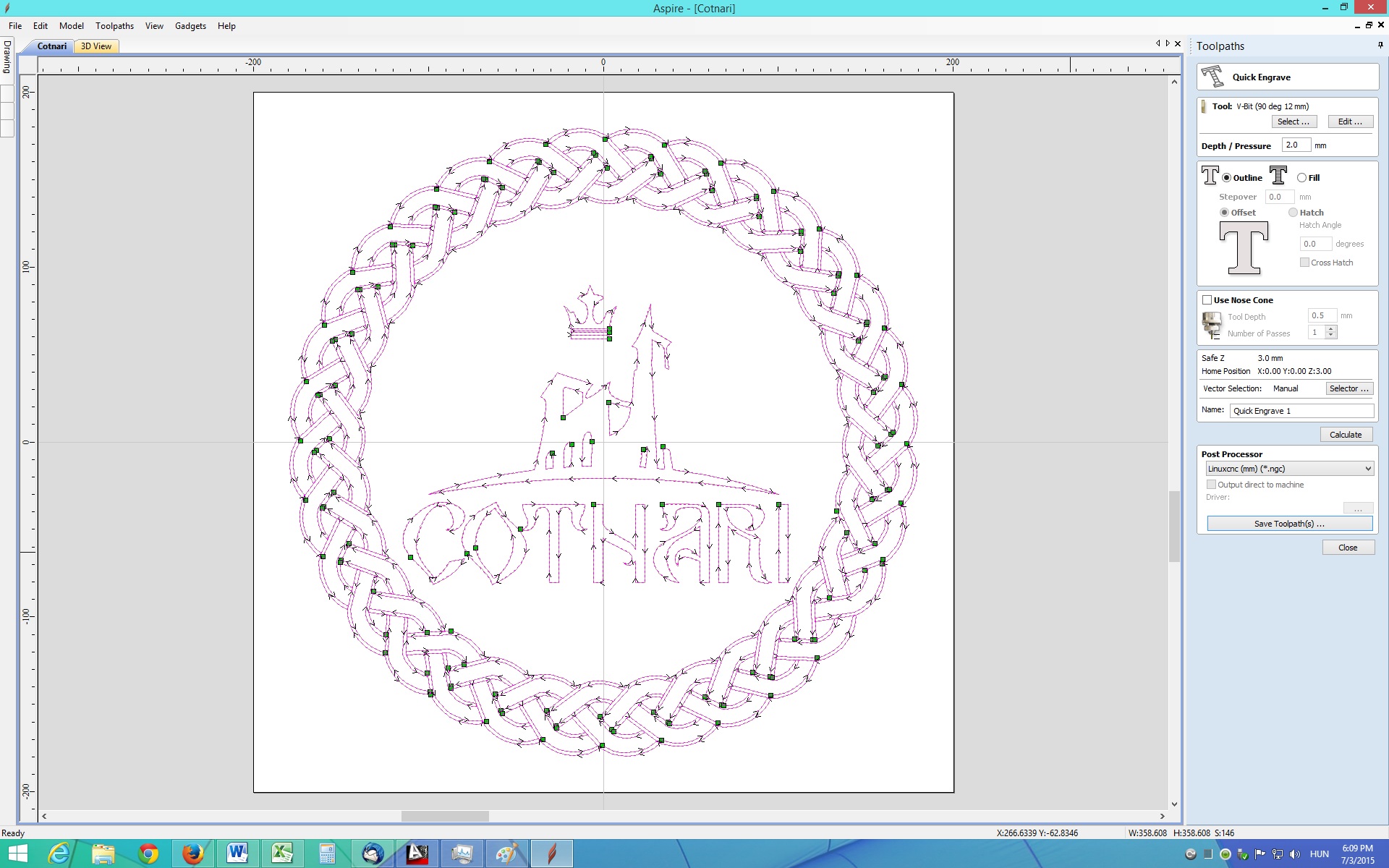

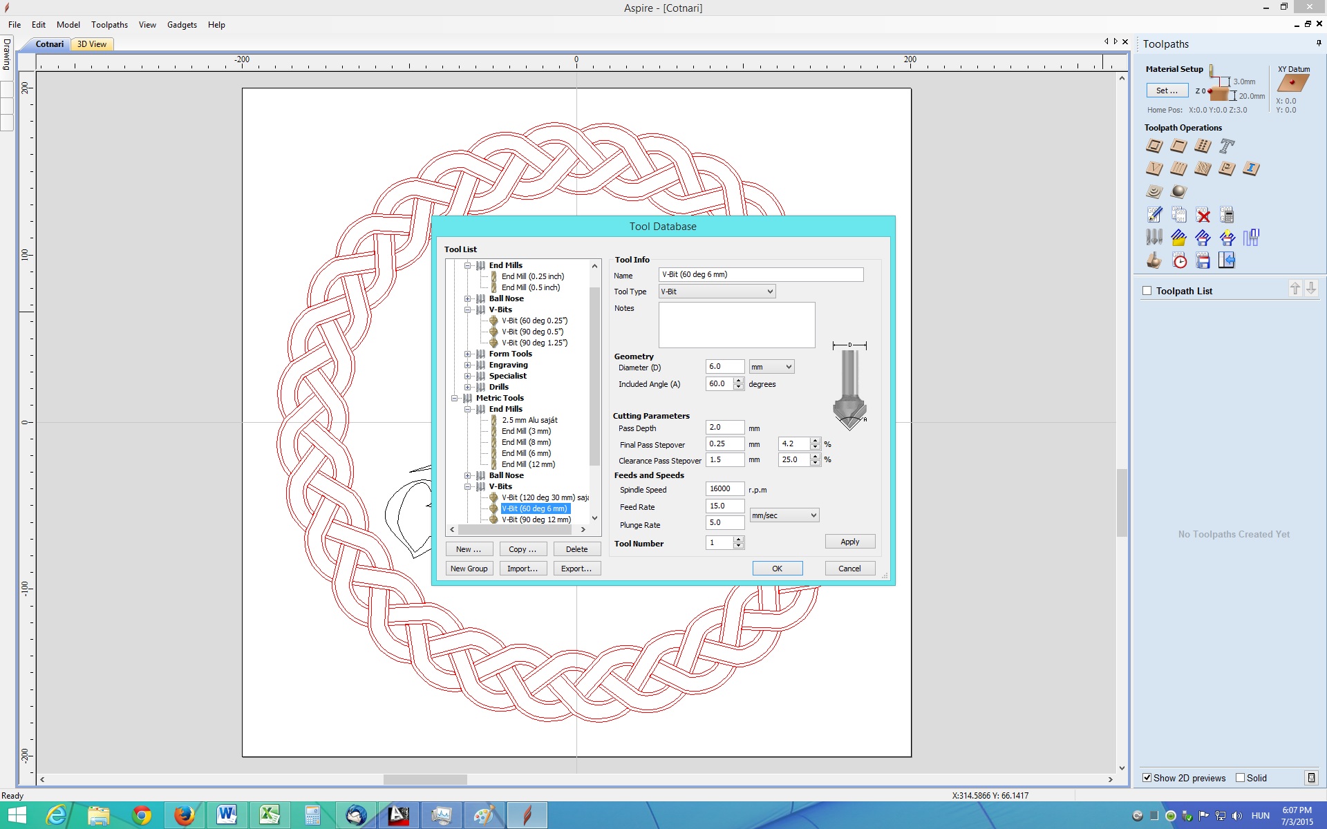

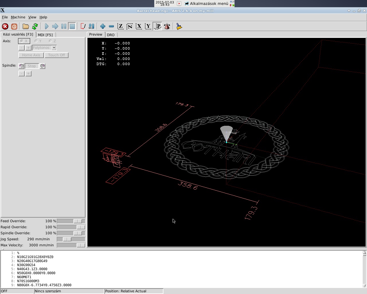

03 Jul 2015 22:28 #60382
by Laci
Replied by Laci on topic Material positioning
Unfortunately I didn't succeed.
Here are the steps with print screens:
In Aspire:

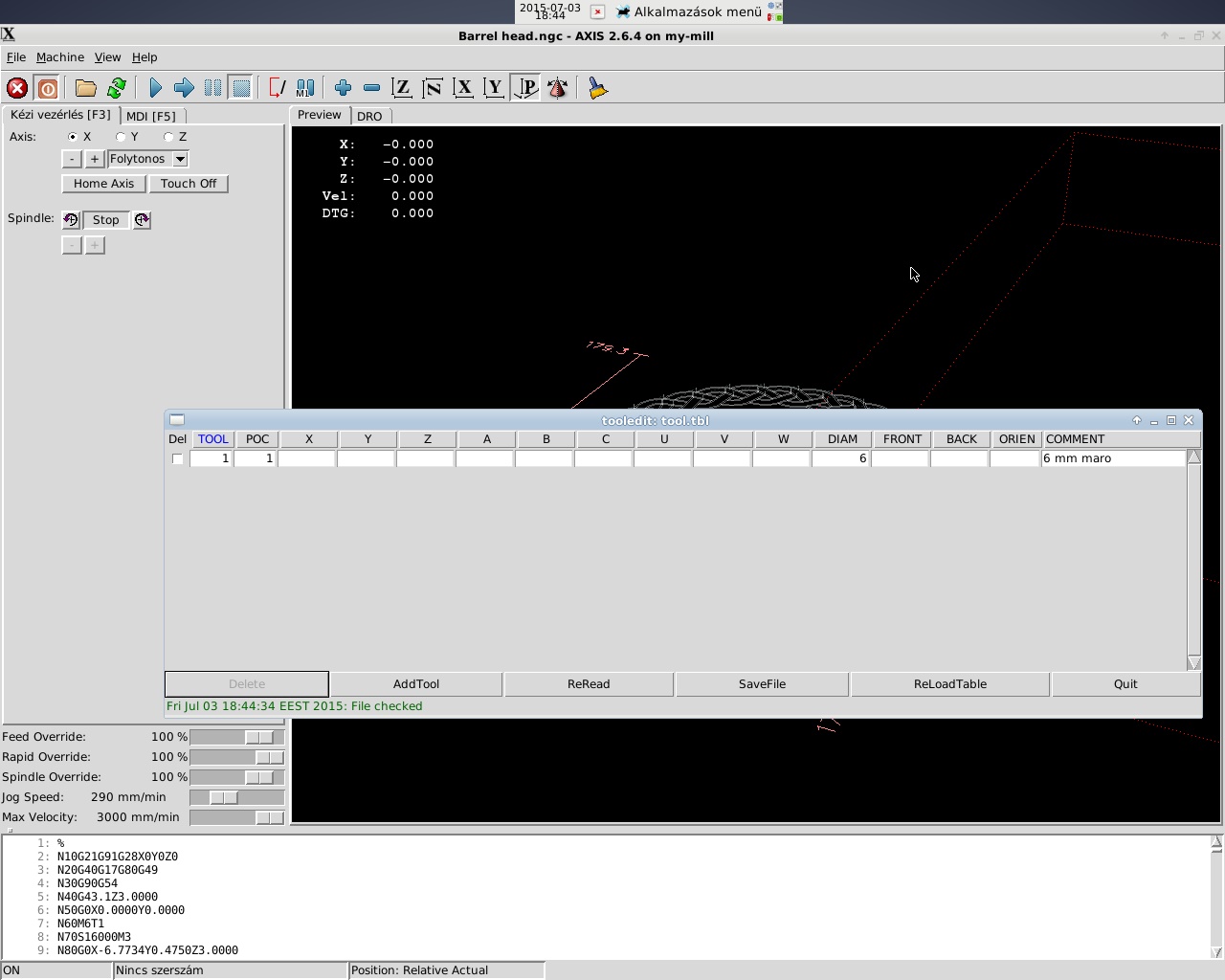

In LinuxCNC:
1. Loading the G code
2. Tool database
3. Top view
4. Homing and touch off
5. Homing and touch off done
Second part coming. Could not load more files.

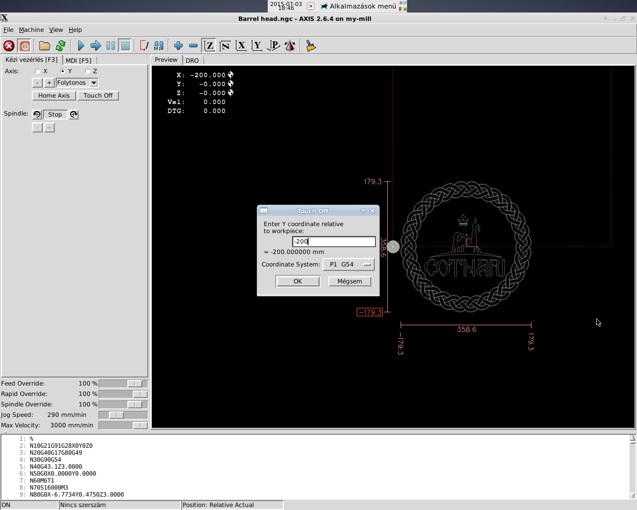

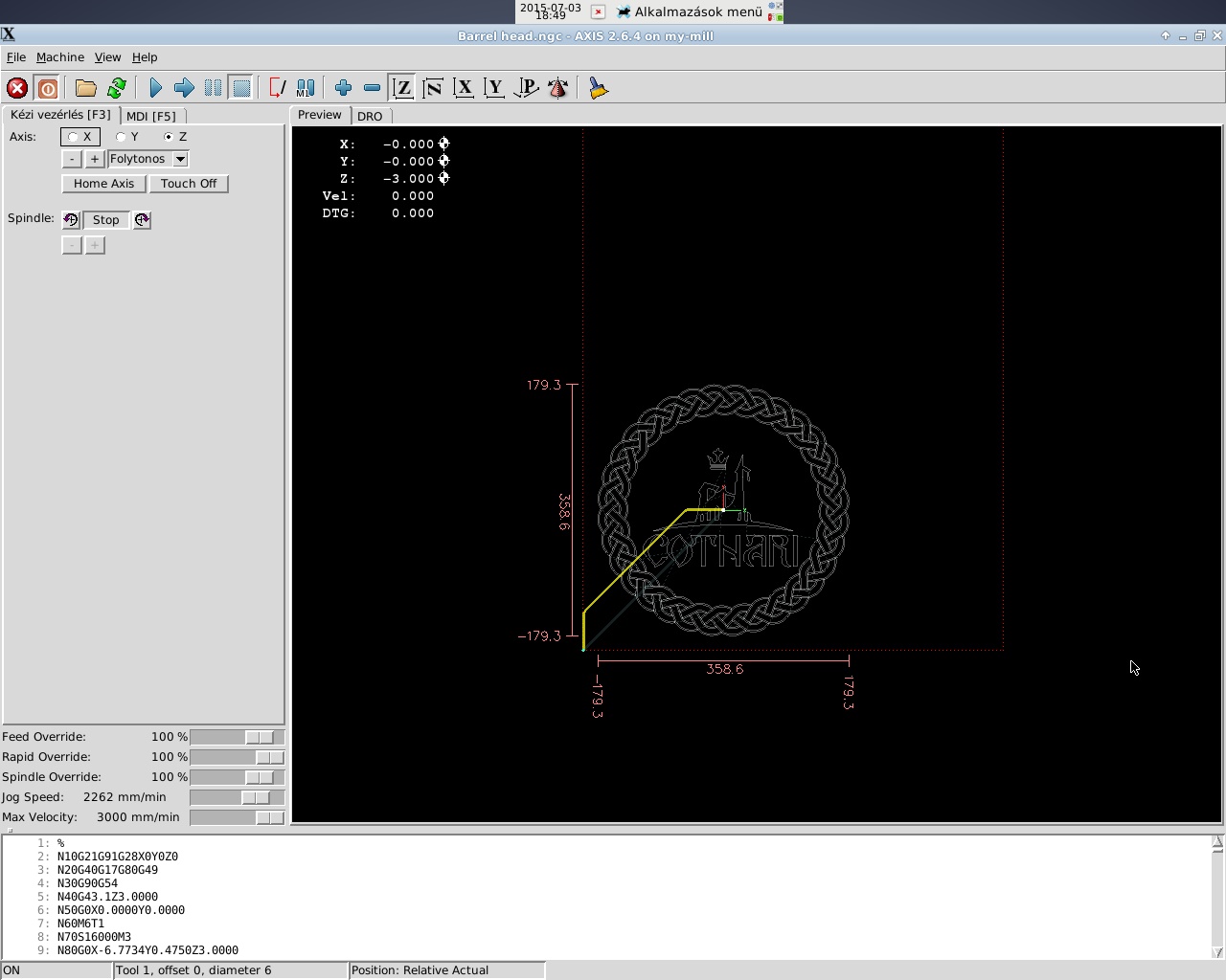

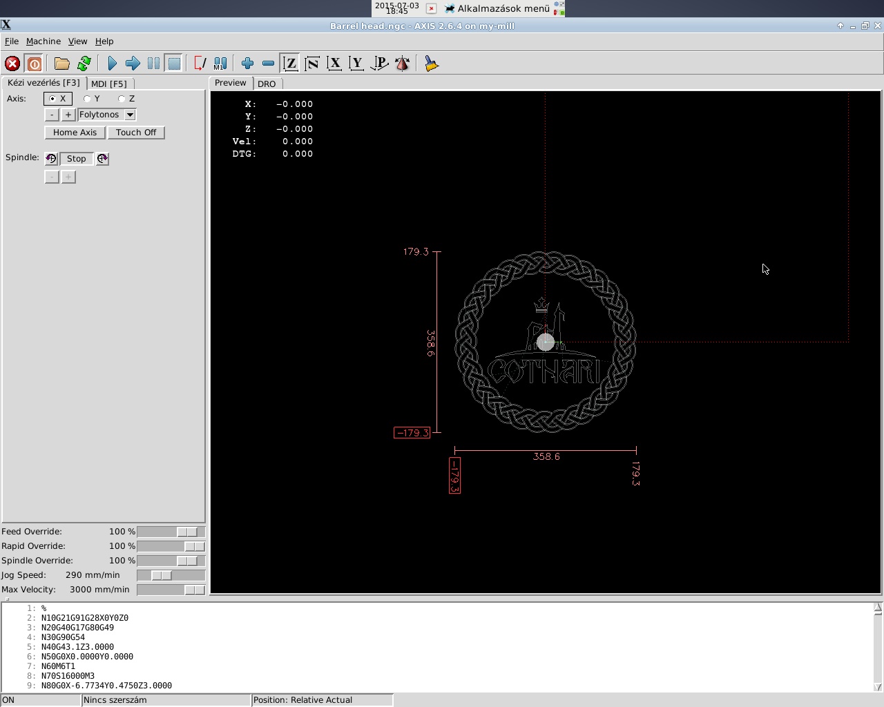

- Laci
- Posts: 5
03 Jul 2015 22:35 #60383
by Laci
Second part:

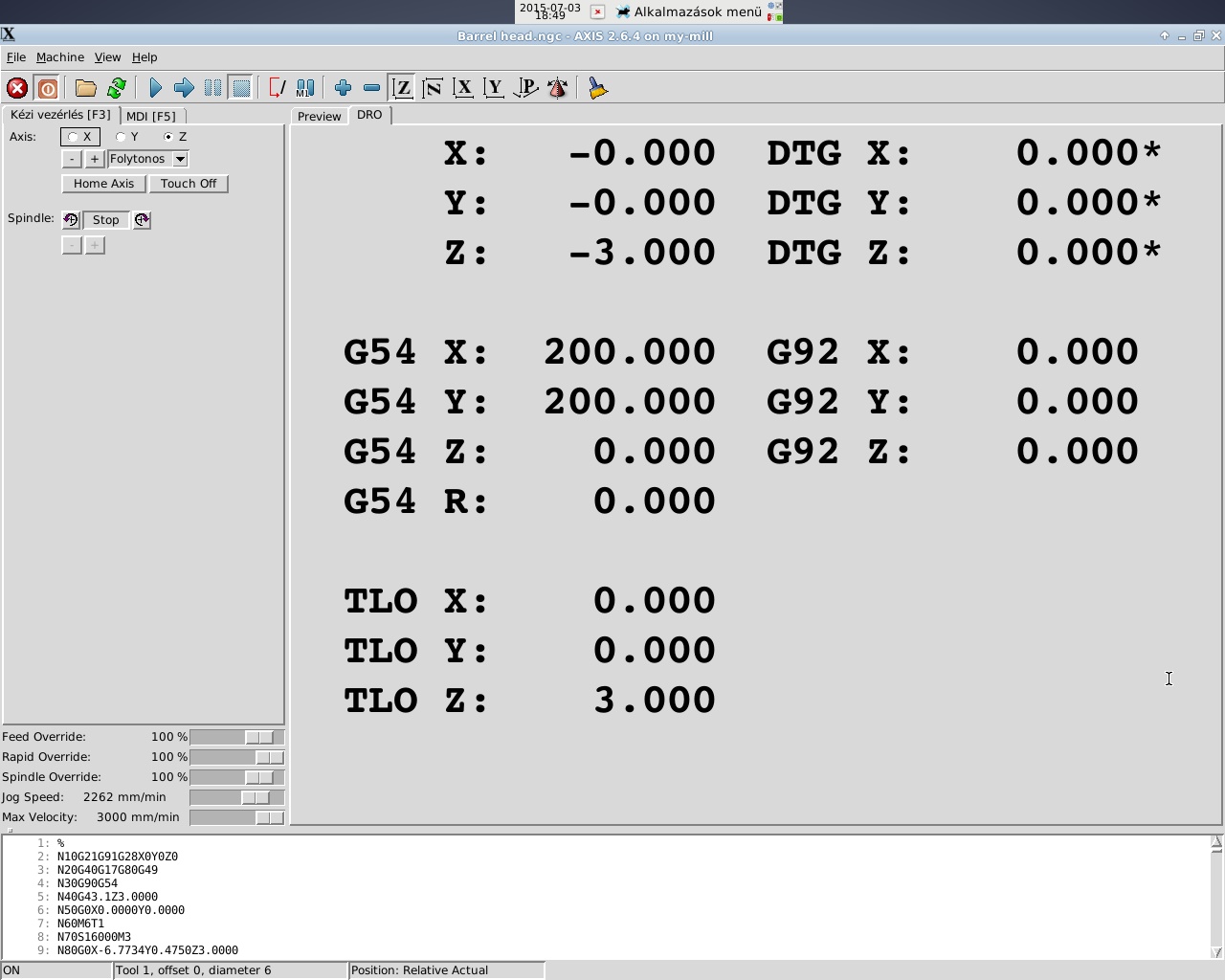

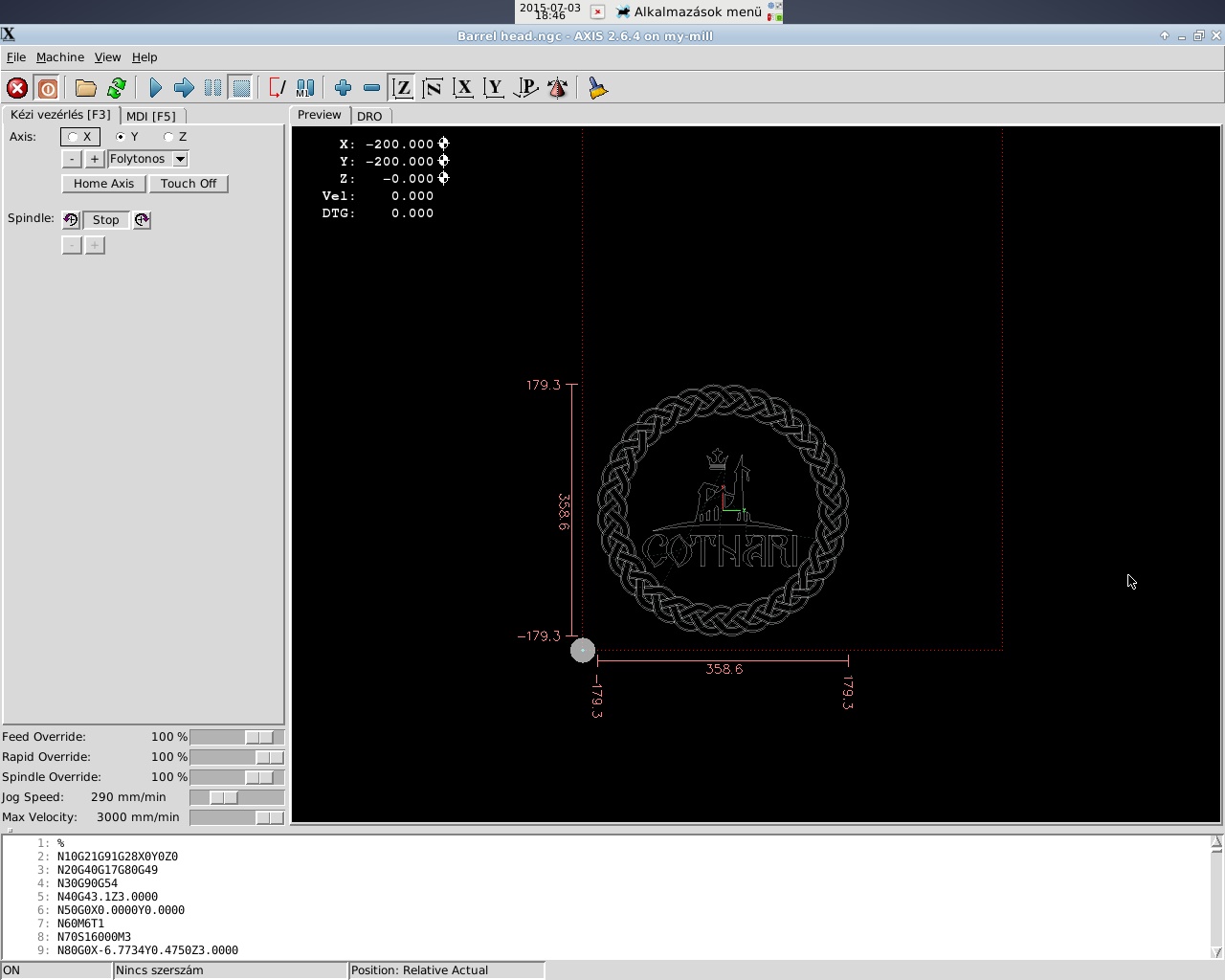

6. Touched off in the middle of the barrelhead. ( Touch off JPG ). But when started to carve, the spindle first went to the bottom left corner, then back to the middle of barrelhead.
It should start right at the touch off points, right?
7. Also I made a picture about the DRO.
I don't know what it would be the right setting, or what am I do wrong.
I quess it might be the Position: relative actual. Don't know.
If you could help me it would be great.
Thank you in advance.
- Posts: 23383
- Thank you received: 4968
04 Jul 2015 00:14 #60389
Not necessarily. Touch-off sets the 0,0 position. Your G-code starts with a move to X -6, Y0.4
I think that the problem is the G28. That is a "return to home" and if you don't have a G28 position set then perhaps it is just going to machine origin. I think you probably want to remove that whole first line.
Replied by andypugh on topic Material positioning
It should start right at the touch off points, right?.
G21 G91 G28 X0 Y0 Z0
G40 G17 G80 G49
G90 G54
G43.1 Z3.0000
G0 X0.0000 Y0.0000
M6 T1
S12000 M3
G0 X-6.7734 Y0.4750Z3.0000
