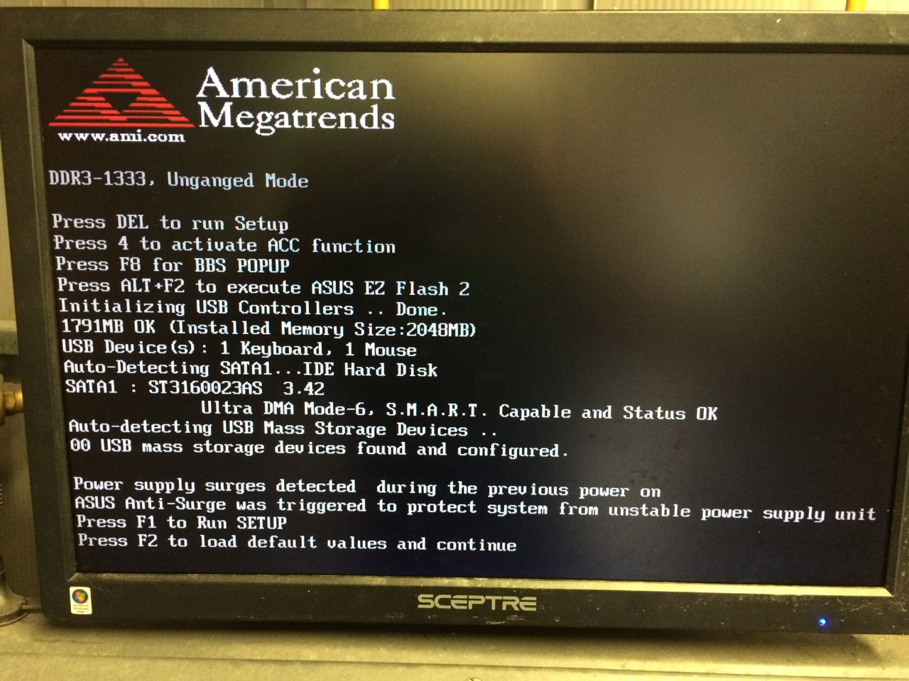

My issue wasn't a configuration issue. The config had been used untouched for years for a machine used everyday. It only gets turned off when we loose power. A power surge caused some surge protection feature to reset the BIOS. The default settings were causing the error. Once realizing what was going on, I disabled quiet n' cool and C1E (or something like that). That resolved the issue for me. So, BIOS issues...

02 Sep 2015 23:58 #62067
Replied by Todd Zuercher on topic USRMOT: ERROR: command timeout
If powering down the PC caused the BIOS to reset to the factory defaults, then the CMOS battery on the motherboard is almost certainly dead. (Not at all surprising on an older PC.)

13 Oct 2015 08:40 #63727
by bottleworks
In my case (as noted above), it was caused by a power surge. The motherboard is only a few years old. I installed a new battery when I built the system. The battery is still good today. I had another surge today, so I took a photo. I've attached a photo of the prompt for those who haven't seen this before.
