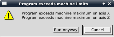

01 Sep 2015 06:51 #61978
by tome
Program exceeds machine limits error using G33 (in 2.7.0~pre7) was created by tome
We get the error below when we try to run G33. The program runs if we select "Run Anyway" - it doesn't exceed the limits yet the error always comes up. What would cause this?
Here is an example of code that causes it:

- BigJohnT

- BigJohnT
- Posts: 3981
- Thank you received: 994
01 Sep 2015 16:07 #61997
by BigJohnT
Replied by BigJohnT on topic Program exceeds machine limits error using G33 (in 2.7.0~pre7)
You have max limits of 0.001 for both axes, when I run the program in the simulator the X axis ends up at 0.400 which is greater than 0.001 so I would expect and error but how it runs for you is unknown to me. Your not selecting a tool in your G code so I assume your doing some touch off before running? Seems to me the last line should be G) Z#<safeZ> but you don't define that.
JT

- cncbasher
- Posts: 1021
- Thank you received: 202
01 Sep 2015 17:38 #62007
by cncbasher
Replied by cncbasher on topic Program exceeds machine limits error using G33 (in 2.7.0~pre7)
for me the z axis is wrong ?
MIN_LIMIT = -2.106
MAX_LIMIT = 0.001
this is a lathe yes , so ok you have reversed the stepper drive to get the motors running in the correct direction , i would prefer to have the software correct and
reverse the stepper motor wires so the sense of the software is correct , in a sense you have ferror as 1 where it should be -1 to have the same sense
these ferror limits you have set , are just not obtainable using stepper motors .
you just dont need them for steppers , so the ferror etc are pure software calculation , and cant be relied on in real life as theirs no feedback
i'd open the max limit to 0.2 .
it's far better to match the machine to the run in the correct sense , even if it means rewiring a stepper driver to do it , then at least the calculations will run the correct way
this can catch you out for instance on a spindle when screw cutting .
be a bit more conservative with values and the problem you have should go away .

- tome
- Posts: 116
- Thank you received: 11
01 Sep 2015 19:45 - 01 Sep 2015 20:10 #62016
by tome
I think it is the 0.001 max limit that is causing it, but if I set it larger, to say 0.5 or higher don't I run the risk of sending my axis beyond it's zero point? This is a back tool lathe and my as such moves from X=0 to X= -2.1 and Z=0 to Z= -7 (or thereabouts). Doesn't setting MAX_LIMIT to 0.5 mean it can move back beyond it's home (zero) point in a program?
The program I posted doesn't do tool loading as we just did a simplified example of the issue. We loaded tool 1 and touched it off outside the program and it doesn't end up a 0.400 (or anywhere outside our limits).
-Tom

- BigJohnT
- Posts: 3981
01 Sep 2015 21:56 #62024
by BigJohnT
Can you elaborate on how you loaded the tool and touched off? Does this lathe have a turret and use the tool table?
And no, you don't want to set the limits outside the physical limits.

- tome
- Posts: 116
02 Sep 2015 04:32 #62037
by tome
The lathe has a turret. We do M6 T1 which loads the tool and also set tool length offset (G43 I think). A button in Glade side panel for each tool runs a script actually. Tools are first touched off to a fixture (wired to Mesa 7i84 input) that is mounted on the spindle head in both Z and X (using G38.something). Then tool 1 is set to the end of workpiece and Z is touched off (G54) and then set on known diameter (or radius since we usually have G8 set) and X is touched off (G54 again).
Tom
