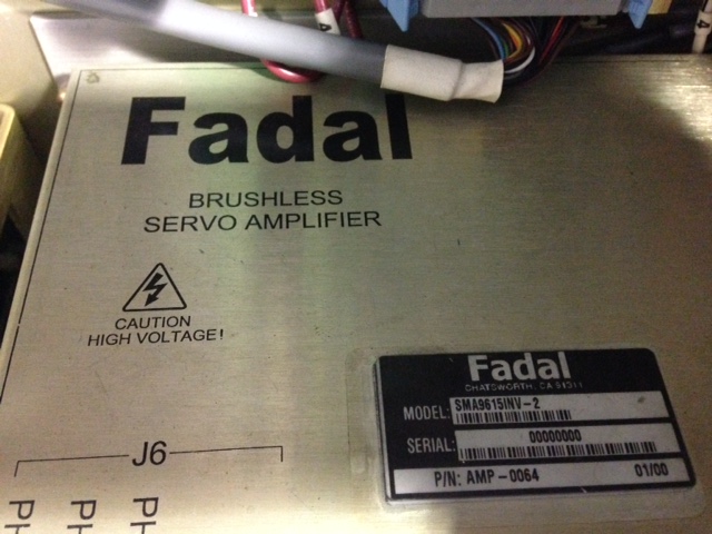

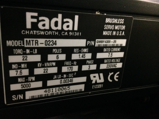

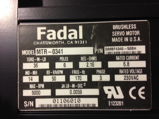

Here are the motors and drivers.
The spindle motor uses the same driver the only difference is it has a heat sink.

Actually, the Fadal control is pretty sweet, it super easy to use, best part of a Fadal. The drives are analog made for Fadal by either Advanced motion controls,Baldor or Glentek, the motors are Glentek or Baldor. They probably use 8192 ppr encoders. It's possible they have resolovers, but I think Fadal went to encoders when they went the AC motor route. The spindle drive is AMC. This machine probably does not have limit switches, it home by lining up a mark on the table and the Fadal control looks for the marker channel on the encoder or the next grid on a resolver and executes a homing routine. You will have to write this your self or add limit switches. There are lots of parts available on eBay for these and the boards are not that hard to fix. Other then the limit switch issue, this could be done in an afternoon, its basically a knee mill. It's not gonna have much spindle torque, I believe it's direct drive 5 hp.
