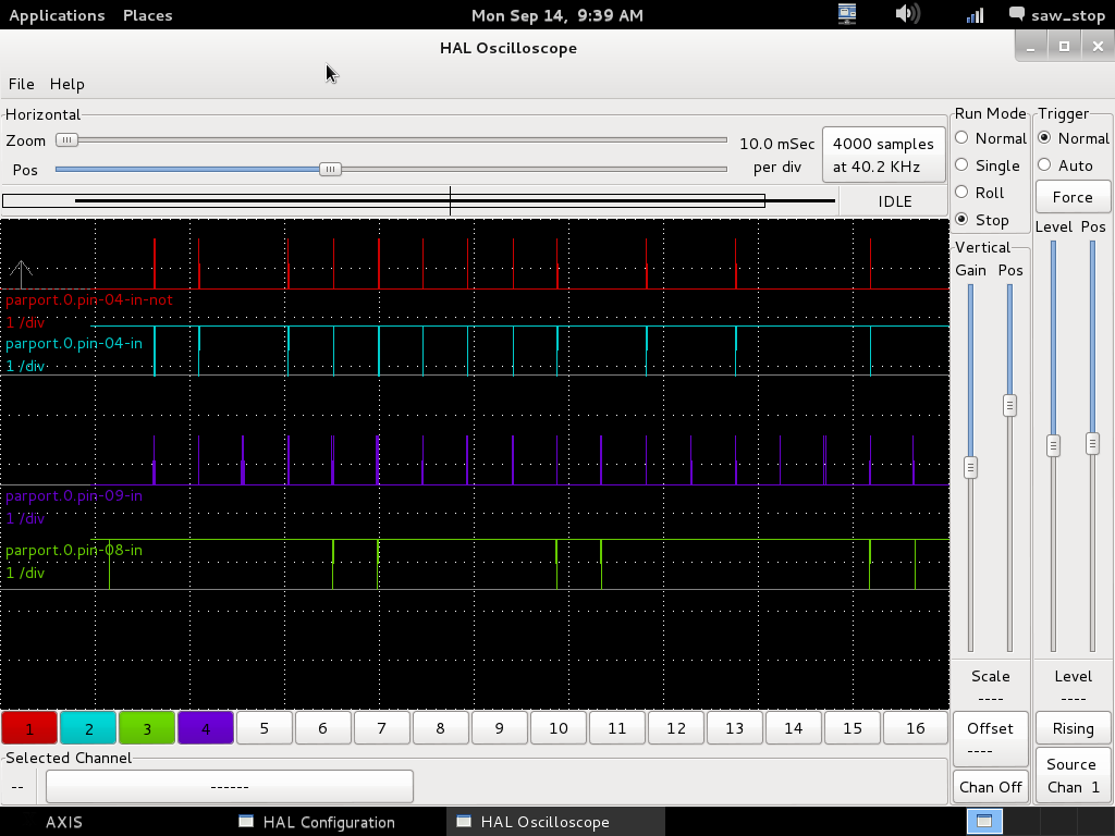

Noise! was created by Todd Zuercher
I am having a lot of trouble with signal noise on a new machine install. I've never had so much trouble with this before with other installs I've done. Here is a picture of the mess I'm seeing. Anyone have any suggestions how to reduce or filter the noise problem. I am also not to sure of the real source of the noise. I am pretty sure it is related to the servo drive. (when I disable it the noise stops)

Fit an input filter to the servo power feed wires, and possibly run the motor power cables through a common-mode choke.
You might also want to see what happens with the servo drive moved outside the box (if the wiring allows that). I suggest this to help determine if the interference is from the drive or the cable runs.

as well as Andys suggestion , run all low voltage cables as screened , especially limits and home
you could also use a buffered breakout with opto's if it's real serious .
make sure low voltage cables are also ran as far from 3ph or power lines as possible
and definately not parallel to them .
