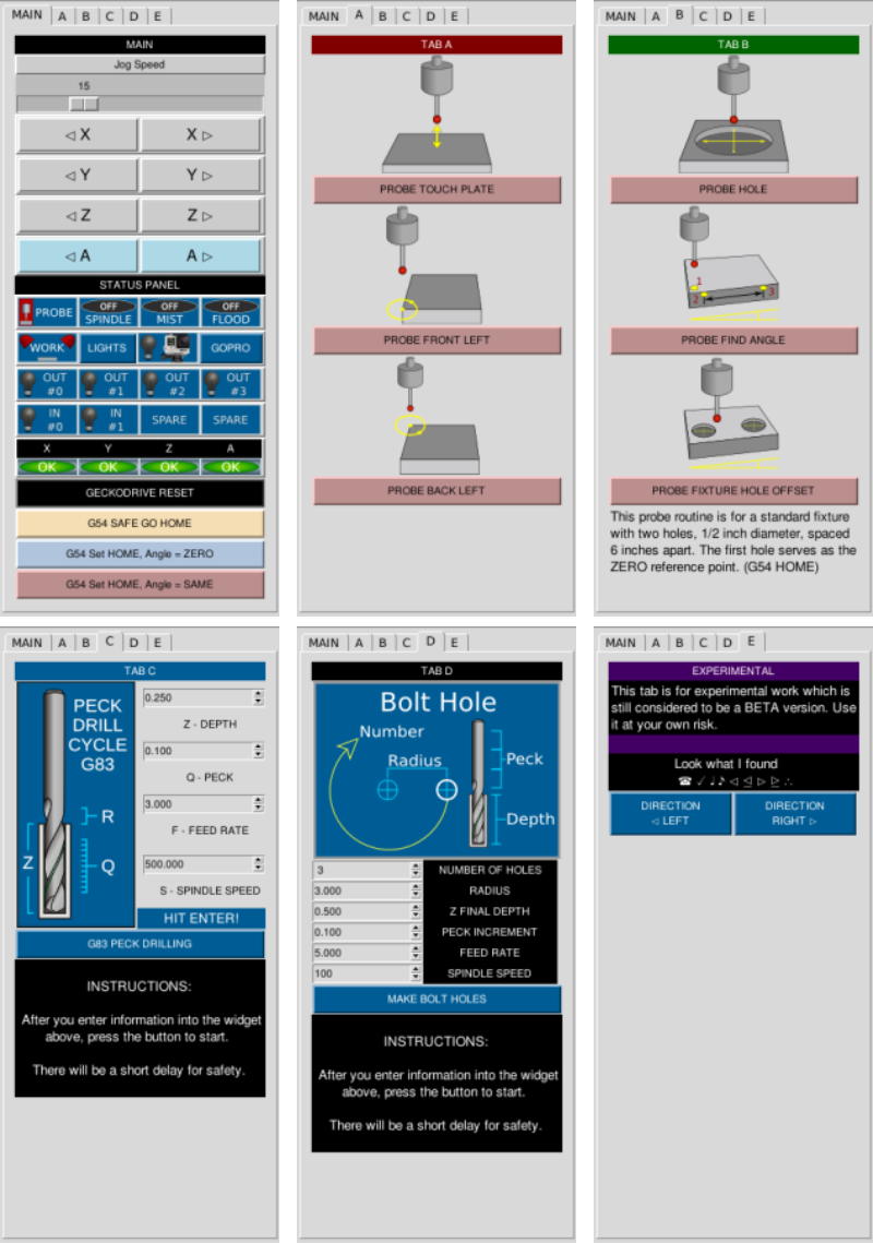

I was tinkering and found out you can do some really nice decorating to the labels and the buttons.
Both buttons and labels (including multilables) support multiple lines and some special characters too.
They also support both foreground and background colors: <fg>color</fg> and <bg>color</bg>
Here is a snippet from my test pyvcp panel...
And here it is on my test pyvcp panel...
So far I found the following characters by experimentation...
<label>
<wraplength>"250"</wraplength>
<justify>"left"</justify>
<text>"Look what I found \n \a \b \f \v \1 \2 \3 \4 \5"</text>
<font>("Helvetica",10)</font>
<width>22</width>
<bg>"#000000"</bg>
<fg>"#ffffff"</fg>
</label>
<hbox>
<button>
<font>("Helvetica",8)</font>
<width>10</width>
<padx>29</padx>
<halpin>"btn-left"</halpin>
<text>"DIRECTION\n\1 LEFT"</text>
<bg>"#005C94"</bg>
<fg>"#ffffff"</fg>
</button>
<button>
<width>10</width>
<padx>29</padx>
<halpin>"btn-right"</halpin>
<text>"DIRECTION\nRIGHT \3"</text>
<bg>"#005C94"</bg>
<fg>"#ffffff"</fg>
</button>
</hbox>
<!-- ========================================================================= -->So far I found the following characters by experimentation...

I have to get out into my shop and rewire the mill... then install the new panel. Once that's done... I'll update the MONSTER learning thread so others can follow along as well. Still trying to decide if I want to install hall-effect sensors and magnets into the spindle for speed reporting. The panel is getting pretty full. I may wait until I tackle my second 1960 Sears Craftsman Lathe and convert it to CNC.
That's going to be a whole new learning curve... programming for a lathe... I don't think my software, Vectric Aspire handles those functions. (I'm sure it doesn't.)
Here are the current panels... as of November 8, 2015
@ BigJohnT - Well... semi-annually then...
