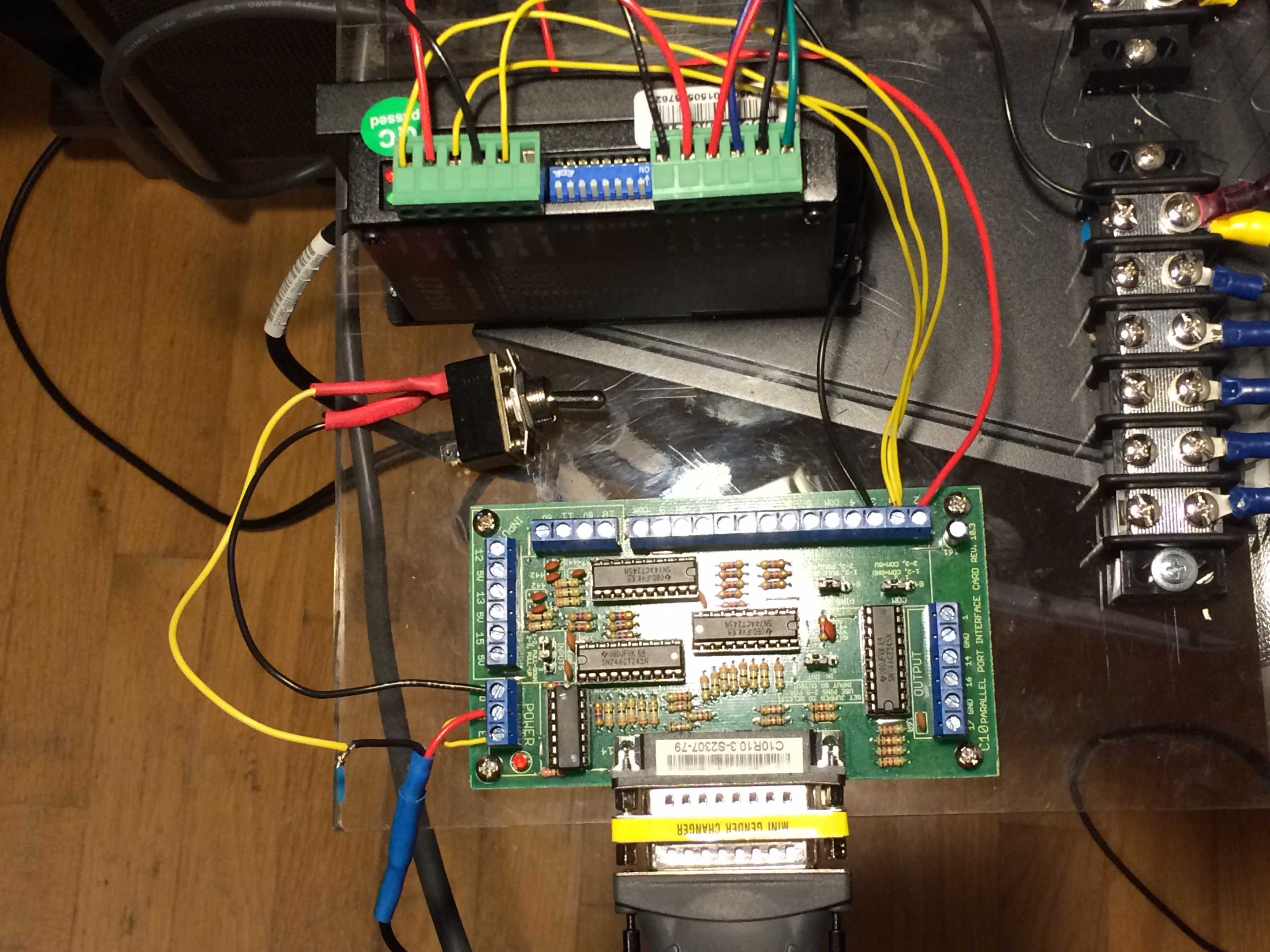

OK I've read the manuals and rewired the Driver, now when I try to control the X axis I can feel the stepper trying to move.
I'm posting a photo of the setup, hopefully it helps.
The breakout board is now configured:
> Pins 2 - 9 are output
> Common to supply 5V
> Pins 2 - 9 are configured as Pull-Up ( does that mean that is supplies power when there is no signal ? )
I still get confused reading the M542T Driver manual, I thought that it uses High signal to Enable driver and Low signal to disable driver. I have 5V from the Common pin going to the ENA+ pin and the ENA- pin disconnected ( I checked the voltage on the ENA+ pin and it has 5V, I checked against the DB25 shield for ground ).
I checked the Stepper manual and I have the correct pair's, I guess it does not matter which pair is A or B
One last question, is there a simple way to check the output from the breakout board to see if the parallel port is working properly? I feel like I'm going blow up the driver or stepper by moving wires around.
Thanks for the help,
Sal

23 Nov 2015 07:32 #65689
by Rick G
It could be you just have acceleration and velocity set too high. Go back and dramatically reduce one or both and test again.
Rick G
Replied by Rick G on topic Help setting up M542T driver
O.K. That would certainly indicate you are getting somewhere and the parallel port is working.now when I try to control the X axis I can feel the stepper trying to move.

25 Nov 2015 01:17 #65761
by salp
Replied by salp on topic Help setting up M542T driver
RickG
I got the stepper motor to work, the timing values I had were not right.
I thought I'd post the timing information for this driver in case some else needs it.
Driver M542T sold by OMC - Stepperonline
Step Time > 1800
Step Space > 1800
Direction Hold > 8000
Direction Setup > 6000
Thanks for all the help.
Sal
