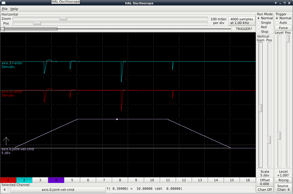

Well, here it is- FERROR peaks at about 0.07.
Axis 3 is sync'ed to Axis 0 (X)
I was still getting Following Error on Joint 0 sometimes when switching from Jog Mode to MDI. When it did that, it could NOT be reset. Toggle EStop/Toggle Machine Power would only repeat the Following Error and no motion as soon as a move was commanded. I had to quit LinuxCNC and restart it.

Can't really tell but sort of looks like a real time error or Ethernet hardware problem to me
Can you tell me what OS (the result of uname -a), Ethernet hardware
and LinuxCNC version you are running?
Have you run a latency-test or latency-histogram? what were the results?
