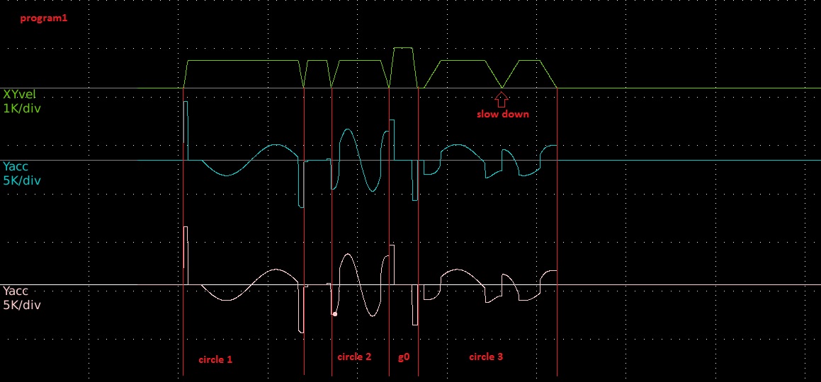

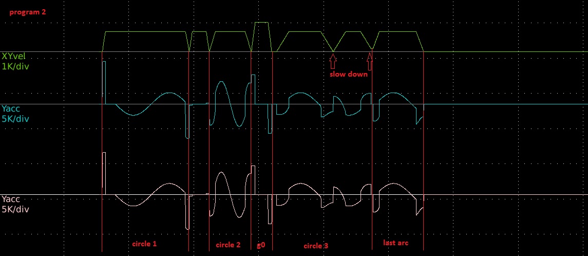

LinuxCNC 2.7.3 Trajectory Planner, circle problem

In sim is the same problem...

It seems to me there was some discussion during the testing of the new trajectory planner about the last or next to last move and acceleration because of the need to come to a complete halt at the end of the program.
What happens if you try this...
or this...
Rick G
g64 p.05 q.05
G90G17G21
G00 X0.000 Y0.000 Z8.000 F34000
G00 X-0.000 Y-0.000 Z3.000
G01 X-0.000 Y-0.000 Z-5.000
G01 X0 Y200
G02 X400 Y200 R200
G02 X0 Y200 R-200
G01 X296.318 Y192.579
G02 X122.567 Y260.113 R-100.000
G02 X296.318 Y192.579 R100.000
G00 X647.090 Y435.084 Z10
G01 Z-5
G02 X299.587 Y570.151 R-200.000
G02 X647.090 Y435.084 R200.000
G01 Z.2
G01 Z0
%or this...
g64 p.05 q.05
G90G17G21
G01 X0 Y200
G02 X400 Y200 R200
G02 X0 Y200 R-200
G01 Z-5
G02 X299.587 Y570.151 R-200.000 Z0
%Rick G

I can't test this program on machine right now, but on simulation is the same problem. You can see on graph that velocity slow down on last circle. I think if that slow down is on simulation then machine will behave the same.
