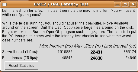

15 Jan 2016 18:03 - 15 Jan 2016 18:05 #68476
by jamby
Replied by jamby on topic Can this computer be used?
Todd
I threw in the towel on the Lubuntu test and burned a disk from the link you sent. I ran it from the disk and did a latency test.
This was run for more then an hour with 4 glxgears running.
What were you saying about a custom kernel? Know any where with instructions on how to do it??
Thanks for your time
Jim
Jim
Last edit: 15 Jan 2016 18:05 by jamby.
15 Jan 2016 18:07 #68478
That's good enough. (better than my machines).
Upgrade LinuxCNC as far is it will let you then move on to the fun stuff.
Replied by andypugh on topic Can this computer be used?
Todd

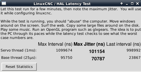

15 Jan 2016 18:31 - 15 Jan 2016 19:13 #68482
by jamby
Last edit: 15 Jan 2016 19:13 by jamby.

16 Jan 2016 04:14 #68514
by jamby
Todd, Andy and All
Thanks so much for all your help. I am giving up on the old insignia machine even though it has great latency numbers 17426 wow. But I am unable to upgrade the emc2 because of repository errors. I followed the upgrade to 2.6 instructions on the wiki and none of the repositories would work. Something has changed but I don't have the patience to figure it out. I followed the address in a browser and the repositories are there but some info is missing.
Checking into the kernel links Todd gave me didn't work out as the first page lead to a dead link for the kernel. And the discussion on the second link proved to me that kernel mods are beyond me. Things are certainly more complex then ten years ago when I made minor changes to a Red Hat kernel.
So back to my Dell 745 with the latest wheezy and 2.7.3 loaded and running. Now I am waiting on the 7i77-n-5i25 kit I ordered yesterday to arrive then I'll be back posting in Milling Machine and looking for lots of info and help.
Much appreciated.
Jim
