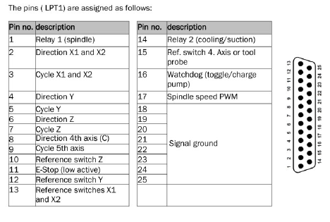

Replied by ArcEye on topic Lapic error causing real time to stop.
Now we know what we are dealing with, should be easier.
There are others far more knowledgeable on Mesa stuff than me, I'll leave them to discuss the merits of different boards.
The main thing is that a 5i25 is not a parport replacement in any literal sense, so it needs to be interfaced with your controller.
This could mean taking your controller apart and rewiring the DB25 IN socket, or keeping it intact and arranging interfacing in a non destructive way.
If you want to add extra hardware, this is the ideal time to do the whole lot in one go.

this is done , oz has the bit file , it is aligned to match the information i was given , re pinouts etc .
is the parallel port cable to the correct spec ?
or is there parts i'm not being told .

Replied by andypugh on topic Lapic error causing real time to stop.
I think the problem is that you are connecting the 5i25 direct to the DB25 plug on the controller as if it was a parallel port.
With the right bitfile that is likely to be OK.
The only "special" pins are the stepgens and the spindle PWM (and potentially the watchdog, but I rather expect that that will work at 500Hz)
The DMM bitfiles are close, in that they have the step and dir pins the right way round.
If you don't already have it, you can download the files from:
www.mesanet.com/software/parallel/5i25.zip
If you extract the archive then you can look through the .pin files to find one that matches your driver.
5i25_dmmbob1x2.bit looks like this:
IO Connections for P3
Pin# I/O Pri. func Sec. func Chan Pin func Pin Dir
1 0 IOPort PWMGen 0 PWM (Out)
14 1 IOPort None
2 2 IOPort StepGen 0 Dir (Out)
15 3 IOPort None
3 4 IOPort StepGen 0 Step (Out)
16 5 IOPort None
4 6 IOPort StepGen 1 Dir (Out)
17 7 IOPort None
5 8 IOPort StepGen 1 Step (Out)
6 9 IOPort StepGen 2 Dir (Out)
7 10 IOPort StepGen 2 Step (Out)
8 11 IOPort StepGen 3 Dir (Out)
9 12 IOPort StepGen 3 Step (Out)
10 13 IOPort None
11 14 IOPort QCount 0 Quad-A (In)
12 15 IOPort QCount 0 Quad-B (In)
13 16 IOPort QCount 0 Quad-IDX (In)It has spindle PWM on pin one and quadrature counters on pins 11/12/12 however if you set num_pwm to 0 and num_encoders to 0 then those pins become GPIO.
With a software-generated watchdog on pin 16 you should then be able to move the axes. Unfortunately you will almost certainly need a custom firmware to run the spindle as I have not been able to find a stepgen firmware with PWM on pin 17.

Things are becoming out of sync ? ,
also looking at the 5i25 file you appear to have removed the chargepump stepgen at some stage , so as the controller depends on this , it's not going to work , also after doing some digging Mach 3 appears to use a default 12.5Khz chargepump .
i say appear as i am unable to verify , so it's also possible as well as adding the chargepump back , the rate may need to be changed , as it was set at 1Khz . so a few more items in the pot to look into .

attached is the 5i25 config including the charge pump using stepgen 7 , and set for 10Khz
if anyone wants to check . along with the modified bit file to suit the controller
estop is looped for the time being

Does the bitfile have stepgen 7 on pin 16?
Which bitfile is being used?
- cncbasher
- Posts: 1021
- Thank you received: 202
21 Jan 2016 13:32 #68880
by cncbasher
Replied by cncbasher on topic Lapic error causing real time to stop.
yes stepgen 7 is on pin 16 Andy
custom bitfile is attached also , set up as per the controller inputs
