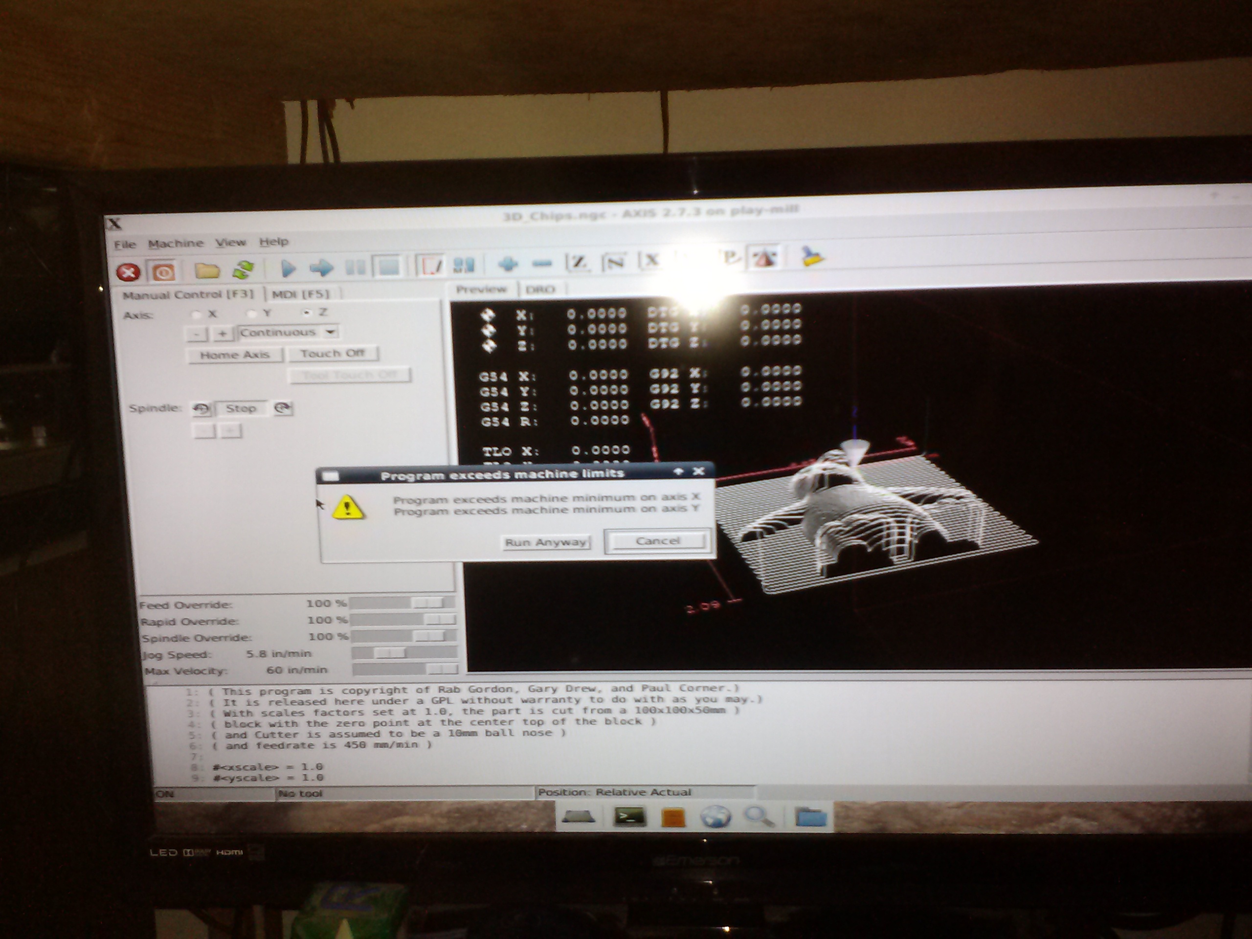

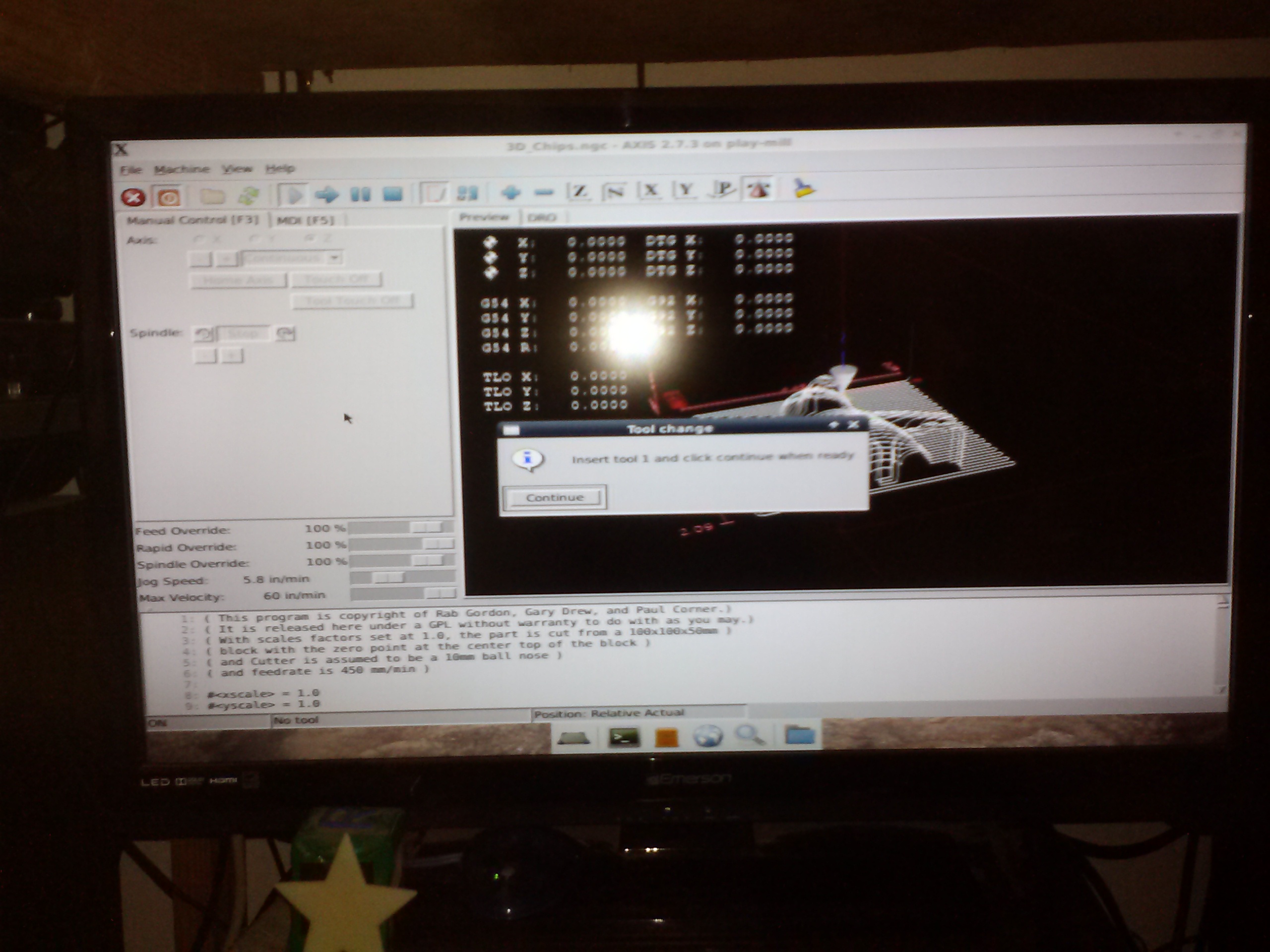

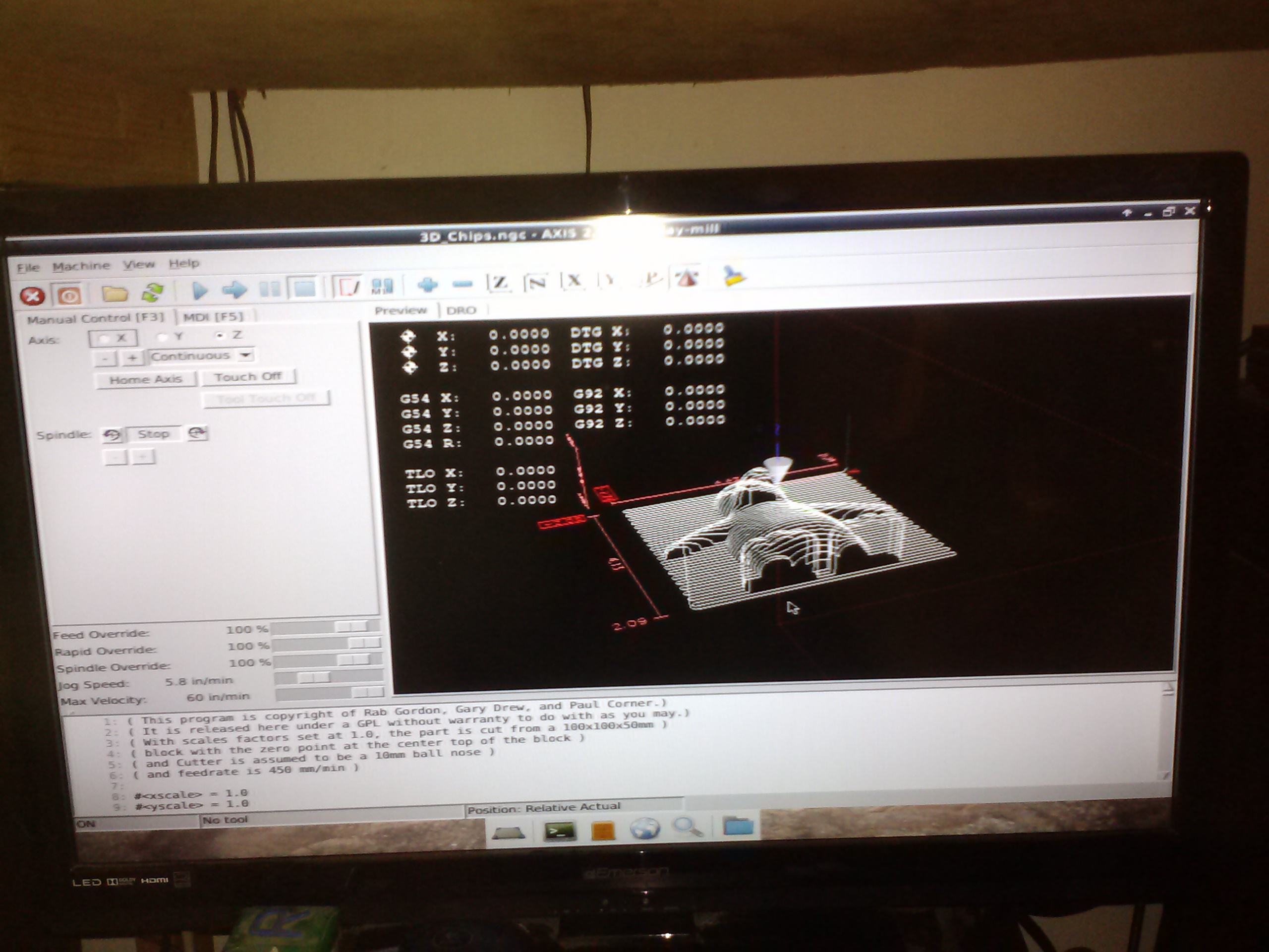

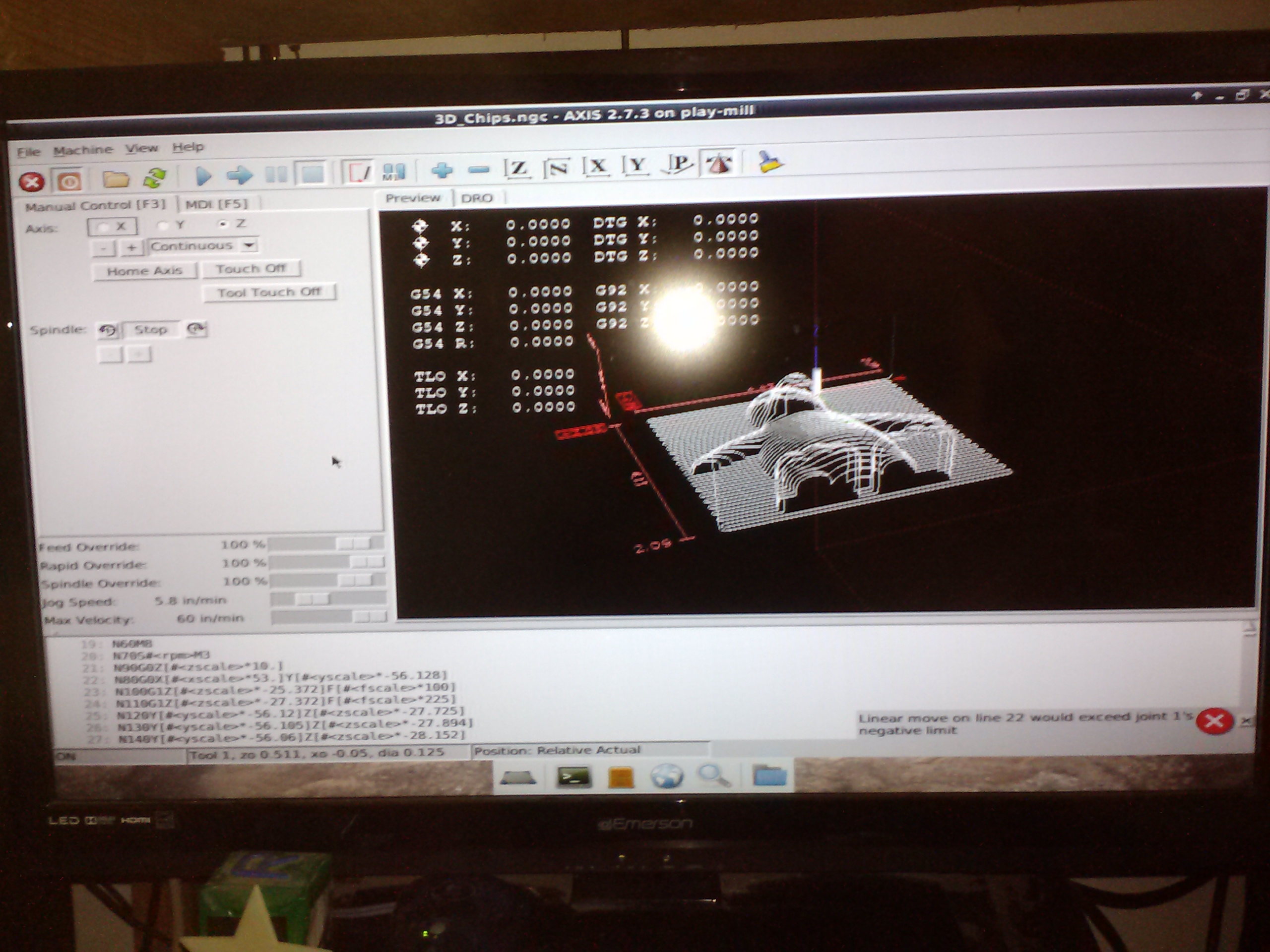

04 Feb 2016 17:17 #69590 by wrongway
Replied by wrongway on topic minum error and homing
I am trying to understand here sorry beer with me if you don't mind but here is where I am getting stuck now I got the homing thing down a bit but still cant get this or anything big like this to run I have a large enough table if I where to try and cut this out when I do get it all figured out and setup here are some picture of whats is going on

04 Feb 2016 17:44 #69593 by Todd Zuercher
Replied by Todd Zuercher on topic minum error and homing
If you look at your pictures, you can see the table limit (the fine dotted red 3-d rectange). The X0,Y0 corner of that is going right down though the center of the tool paths.
If you would touch off so that the current position of x and y (your machine origin) is something like x4 and y4. The file should run for you.
There are several way you can do that, you can press the touch off button and input 4, or you can jog over 4 and press the touch off button and press enter.
There are more ways to do it, but baby steps first.
