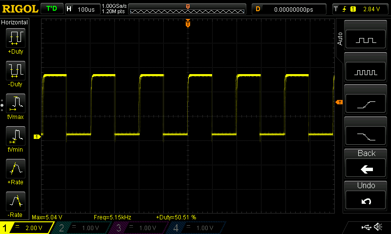

Hey, may I sneak a quick question in to this topic?
I would like to adjust diode laser power with M67 too - but as it is called analog output do I need additional hardware like a DAC? Or is there an easier way to get PWM out of a parallel port pin without slowing the step planner?
EDIT: Ah, it is hal slang isn't it? I am supposed to net the analog output to a pwmgen and then that to an actual physical parallel output pin right? Any examples where something similar is done?
Am I on the right track with something like this in custom.hal?

Replied by andypugh on topic Laser Control by Spindle PWM
I came here to answer and found you had answered your own question
You HAL looks right, from a cursory glance.

25 Feb 2016 14:09 - 02 Mar 2016 18:27 #70617
by purged
Replied by purged on topic Laser Control by Spindle PWM
