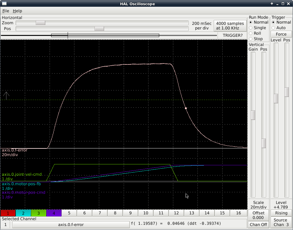

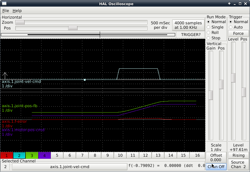

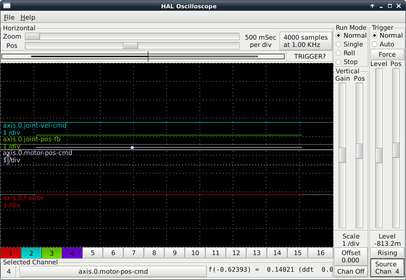

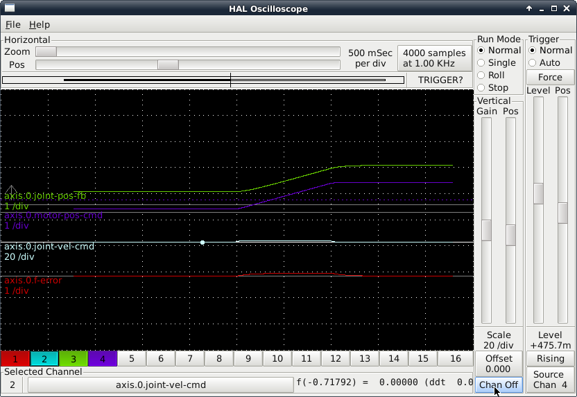

Todd, JT

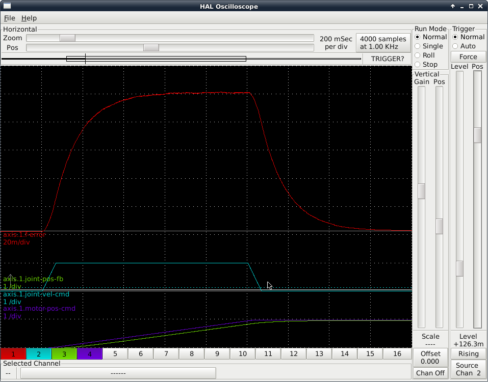

I've got a interactive HalScope session running. Channel 1 is "axis.0.f-error", channel 2 is "axis.0.joint-vel-cmd", channel 3 is "axis.0.joint-vel-fb", and channel 4 is "axis.0.motor-cmd".
Using MDI mode to move X axis back and forth 1.0 inch at a time.
Run Mode is set to "Normal", Trigger is set to "Normal". I have tried all 4 channels as trigger but still don't get anything on the screen.
Do you see what I am doing wrong??
Jim
Jim

Use the vel pin as a trigger and move the level to just above the blue line so when the vel passes the trigger a trace is recorded... don't worry it took me a while to sort out halscope in my head too.
JT

Time to tune! Make adjustments like the tutorial and observe the results then adjust...
JT

Am I suppose to bring the hump in the line down along the original line?
Jim

Yes, you want to reduce the following error as much as you can.
JT
