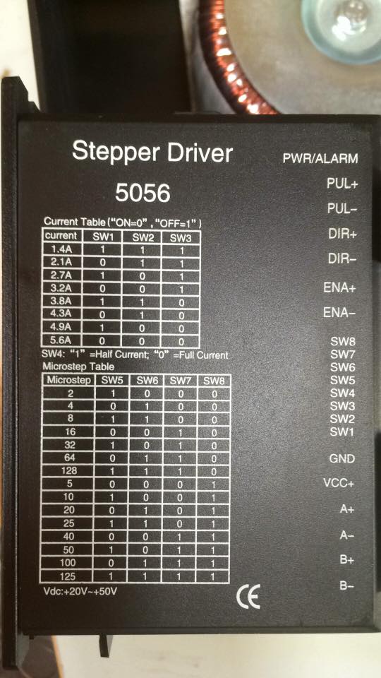

- sandman92k
- Posts: 42
09 Feb 2016 17:39 #69867
by sandman92k
Replied by sandman92k on topic kl 5056 driver setings help
so it is set at 50, what is that

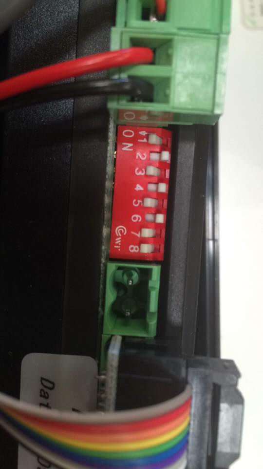

- sandman92k
- Posts: 42
10 Feb 2016 01:51 #69899
by sandman92k
this page is the set up directions for my KL5056 driver, currently the drivers are set for 1/4 micro stepping, and according to this the motor steps per revolution should be set at 800, is this correct. any input

10 Feb 2016 12:02 #69921
by cncbasher
Replied by cncbasher on topic kl 5056 driver setings help
you don't say what machine your fitting out , however i would leave it at 1/4 step as you have it ( 800 steps per rev )
also beware the higher the microstepping the less torque you will have , a lot of people think microstepping is for resolution
it is not , it is mostly for overcoming resonance , fine for use on small motors such as used on 3d printers for resolution , but for any serious work , keep the microstepping to 1/2 ( 400 ) or 1/4 (800) , is more than ample for all jobs .
