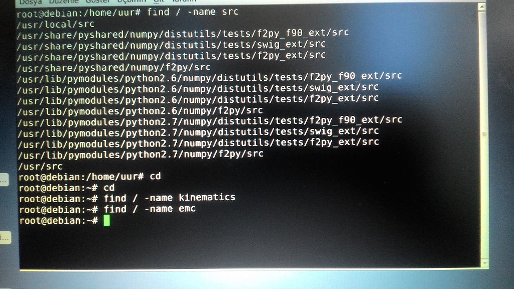

i downloaded scarakins source file.
i want some changes and then compile and test on my scara arm.
actually i have a homing problem for c axis. same problem solved this link. sourceforge.net/p/emc/mailman/emc-develo...CU6A@mail.gmail.com/
i am searching kinematics directory but can not find it. loaded my screen photo
how i can find it ?
How i can compile and install my new scarakins file ?

Replied by andypugh on topic How to find scarakins file in linuxcnc folders ?
How did you compile scarakins?
sudo halcompile --install scarakins.c
Might work, is that what you did?
Your search strategy seems wrong for finding the scarakins.ko kernel module.
