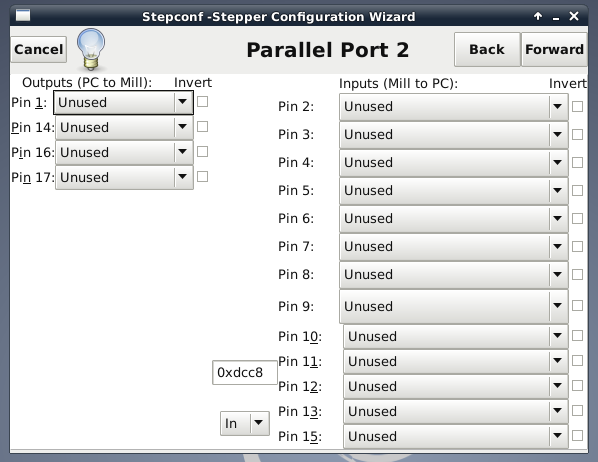

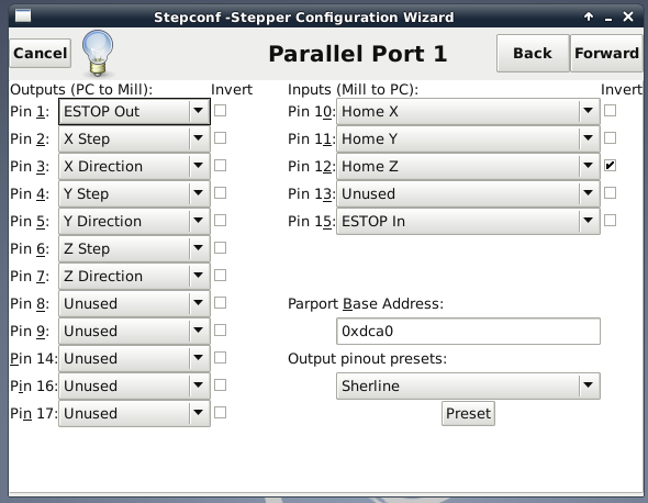

15 Mar 2016 03:03 #71666
by gizmo6023
Replied by gizmo6023 on topic Yet another nube with paralell port problems
Success!
I finally stumbled across the solution, my system does not like the parport index numbers for some reason and providing the hex address for the first port got that one working. There seems to be a change on the parport 2 setup screen, there used to be a label for the address now it is an unlabeled box with index # 1 inserted by default. I finally decided to try plugging the hex address for port 2 in and now it works as advertised.
Perhaps a label will save some one else some aggravation if things don't just work automatically.
Thanks for all the help andypugh
