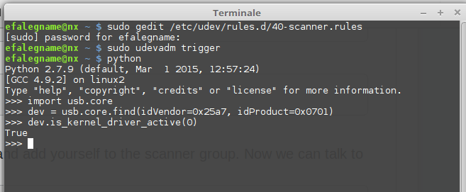

22 May 2016 10:23 - 22 May 2016 10:24 #74939
by eFalegname
Replied by eFalegname on topic Barcode scanning to open gcode
Hello John.
Sorry I didn't answer earlier but I was waiting for the bar-code scanner (like yours) to arrive. I followed your procedure which you indicated in the other thread, I'm able to put the scanner in vcom mode rs232 scanning the manual label and following the python configuration, but there must be something I'm doing wrong because it doesn't load the "o"-gcode at all.
I know this is a very small subject in LinuxCNC, but please don't quit. I'd be greatful.
