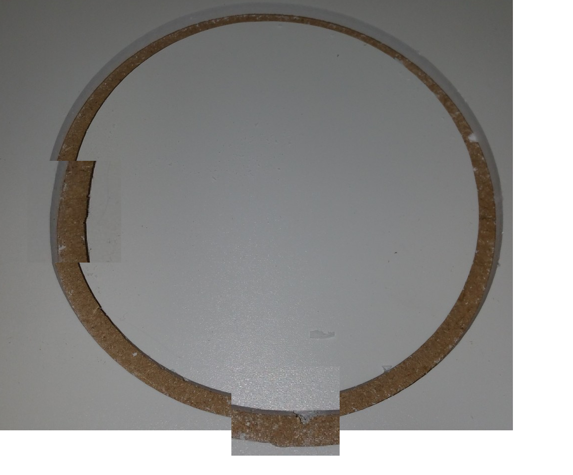

I recently had a new cnc router installed at work run on linuxcnc.
The machine seems to run well except for cutting circles, for some reason it will not make round holes unless a bit is used that is the same size as the hole to be cut. I have been trying to resolve problems with the manufacturer, but that seems to be a dead end.
the square profile of the part cuts perfectly, but the round cuts do not stay round.
has anyone experienced similar issues with circles not cutting round, but ending up sort of blob shaped?

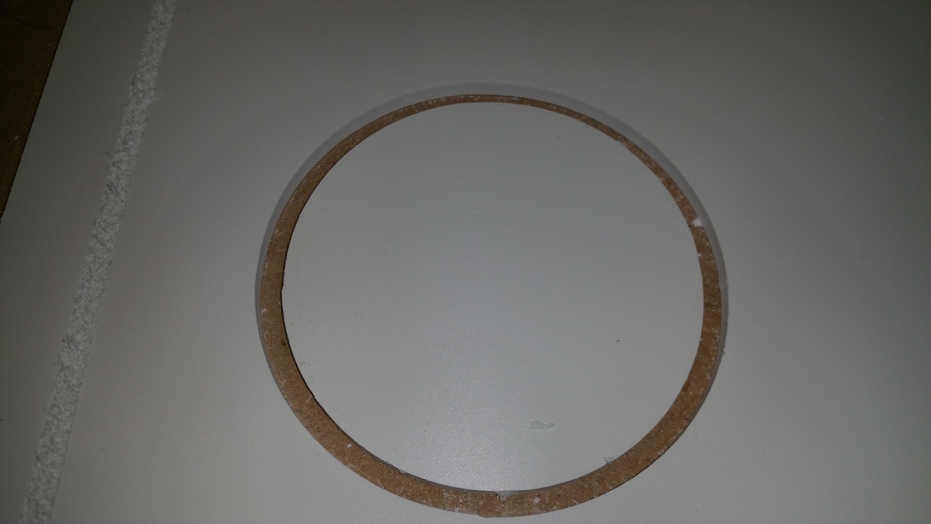

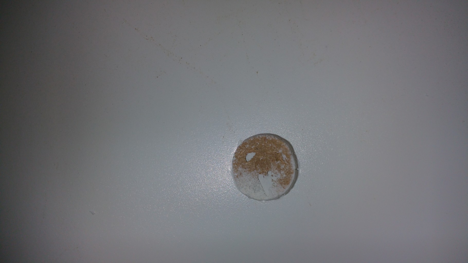

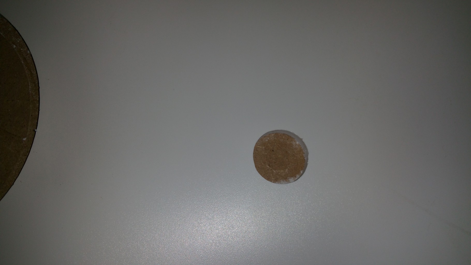

I have been using code generated by vcarve pro. The machine is new, and seems solid. I am attaching a copy of the gcode for the test and some photos of the failed cuts. I suspect a gcode or software problem since we had similar problems with a machine we replaced with this one and the only common features are the computer that runs the machine with linuxcnc, and vcarve.

What material are you milling? How is it fixtured? I've seen marks like that caused by the material moving or flexing under cutting forces.
Backlash is another notorious source for similar marks, especially when cutting circles. Backlash comp can often cover it up on straight line milling, but on a circle the cutting forces can often move the cutter in the opposite direction of the backlash compensation, and when direction reversals occur (such as at the points of the circle) the backlash compensation will cause a bump as it tries to get things back to where it thinks it should be.
Do you know if your machine is using backlash compensation? If a new machine has that much backlash, there is a problem. Setting the backlash compensation to 0 might reduce the distortion by half, but at the cost of distortion showing up more in other places.
I've also seen similar marks made on light machines cutting with cheep router motors, that have too much play in their spindle shaft bearings.

Check out these transitiion points:
On a typical gantry, the cutting tool changes direction on either the X or Y axis at the most extreme dimensions of either axis. Based on the divots you've got at those locations, that's a tell-tale sign of backlash.
To be certain, though, if you see a divot at the most negative X direction, you will likely also see a divot at the most positve X direction, and the same goes for Y.
in your *.ini file, you can set BACKLASH = x.xx, where x.xx is decimal number, for each axis. The software will then make a constant offset each time it changes direction.
To measure the backlash, you'll want a test indicator, but if you don't have one, you can still see if backlash is a problem by adding in some small nonzero values and seeing if that improves the geometry of your cuts.
