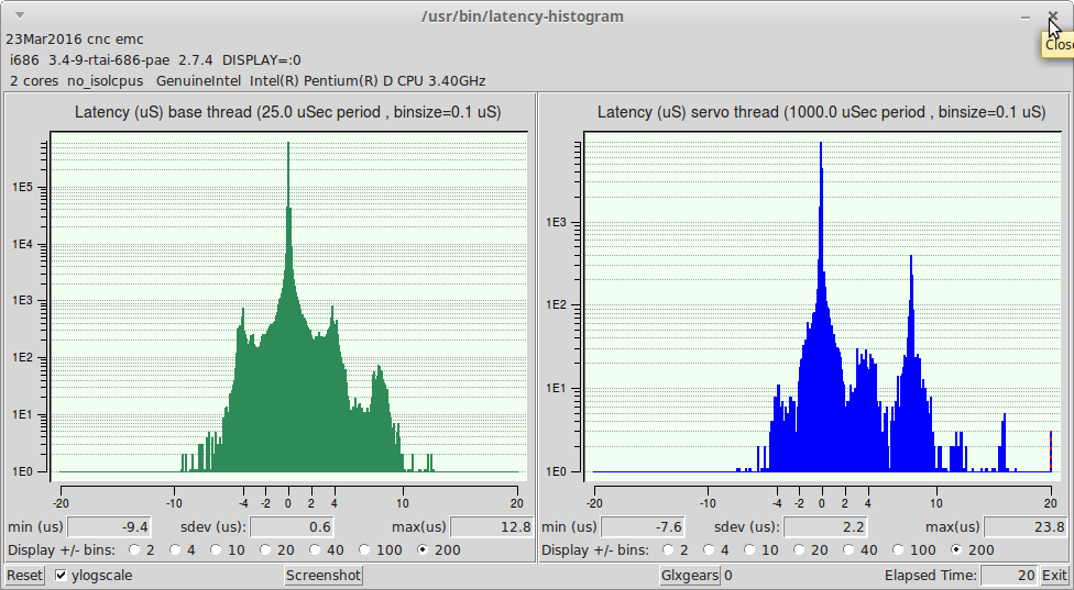

I have two computers, one kind of runs CNC and the other not at all. I have reverted to the not at all model because is has one core and I understand this might be better,
Thanks for the help!
It is a Compaq dc5700 tower
It is an Intel(R) Pentium(R) D CPU 3.40GHz 2048 KB and I just realized this has two cores as well.................
Intel integrated graphics
This is what I get,
