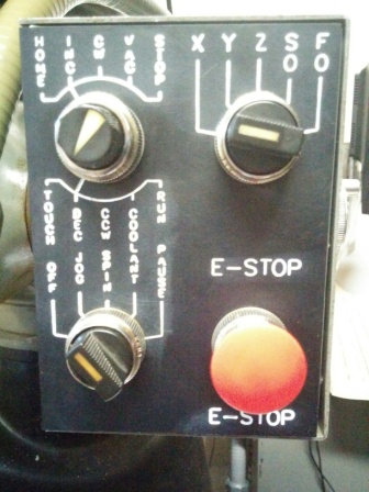

Hello all,
I am finally getting around to putting some external controls on my machine. I have some 5 position selector switches from the old control that I'm reusing. One is used to select the axis / feed override / spindle override and it works good - I had to use several and2 gates with the "-not" version of the four signals that actually do come from the switch to make up the fifth position.
I have two more switches one 5 position like the first and one that is two position push button momentary. I would like to setup these two in a combination so that the two position selects one of two options from each position of the 5 position switch - these are the two switches on the left hand side of the panel in the picture.
I have tried the same technique with this set of switches as the axis selector but it will not let me attach the same physical pin to different and2 gates multiple times. Now that I think about it that maybe the answer to my own question, I'll try putting all of the and2 gate inputs used in the other 5 positions tomorrow - I'm burnt out after a full day of sifting through the forum and manual pages.....
Is there a better way to do this?
Also is there a way to issue a touch off from a button for the axis selected by the switch??
Thanks,
Bogie

You can use a signal over and over but not an input or output.
linuxcnc.org/docs/2.7/html/hal/basic-hal.html#_net
For a MPG with a selector switch simply connect each input to the correct jog enable pin
JT
net x-jog-select axis.0.jog-enable <= hm2_5i25.0.7i77.0.0.input-00
net y-jog-select axis.1.jog-enable <= hm2_5i25.0.7i77.0.0.input-01
net z-jog-select axis.2.jog-enable <= hm2_5i25.0.7i77.0.0.input-02

Touching off to material with a pyvcp button. I use a 3/8" dowel to touch off.
postgui.hal
net z-material halui.mdi-command-10 <= pyvcp.z-material-touchoff
ini
MDI_COMMAND = G10 L20 P1 Z0.375

Here is another way to do this:
If you use a mux-generic with bit-inputs and unsigned32 output you can map any pattern of input bits to any pattern of output bits.
The output bits all end up encoded in a 32-bit int, so you then need a "bitslice" t extract them.
linuxcnc.org/docs/2.7/html/man/man9/mux_generic.9.html
linuxcnc.org/docs/2.7/html/man/man9/bitslice.9.html
A simplified example, 2 input bits giving the OR, AND and XOR outputs.
For a single output the LUT5 component is more elegant but the mux/bitslice way can handle more inputs and outputs (it can map 10 input pins to 32 output pins)
