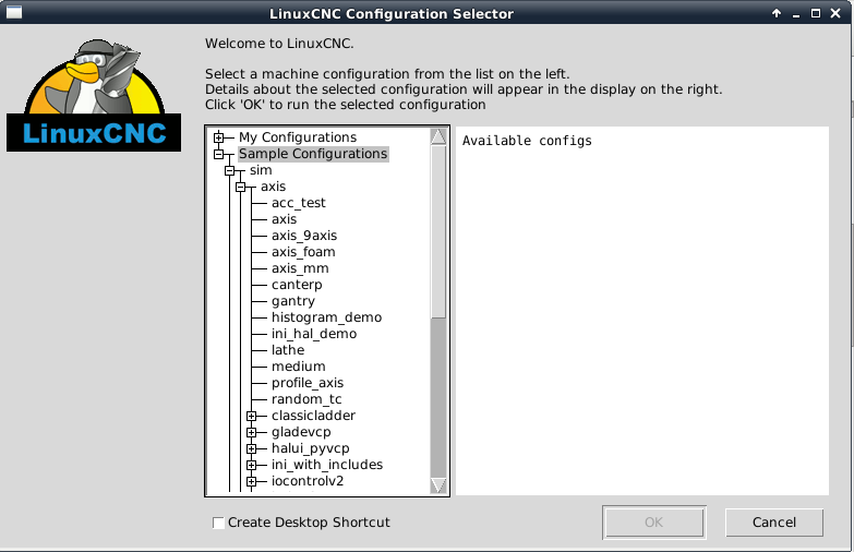

Hello,
My colleague and I have just recently found LinuxCNC and we are thinking that it might be a perfect fit for us. We are currently working on designing and building a 6 axis robot for routeing plastic parts, and we are looking for a good motion controller. We are really excited about what we have seen with LinuxCNC, but we haven't been able to find a good place to start. We were looking to start playing with the Puma demo, but it seems like our version of LinuxCNC didn't come with it. Does anyone have any guidance to a good starting point to see how LinuxCNC can assist us in controlling our 6 dof robot?
Thank you!

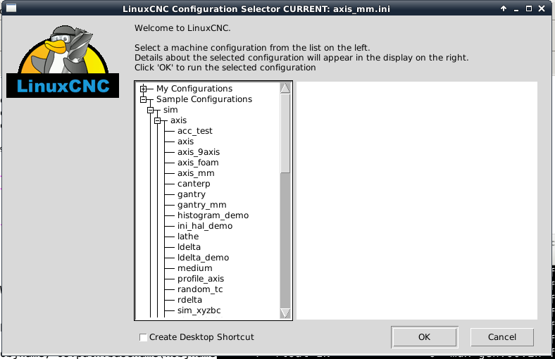

Which version of LinuxCNC do you have?
When you start LinuxCNC you will normally be shown a configuration picker, and you should be able to find two different Puma simulators in sim/axis/vismach/puma/puma560
Replied by andypugh on topic 6 dof arm Demo
The following user(s) said Thank You: Cpk_Rbt

Thanks for the fast reply!
We have version 2.7.4
When we first started LinuxCNC we couldn't find either simulator in the configuration picker. After digging a bit, we found the files for one of the puma demos on github. When we dropped the files into linuxcnc/configs folder it showed up in our configuration picker, however; when we try to run it, it fails with this:
Thanks again for all of your help!

We have been puzzled as well. Attached is a screenshot of our Sample Configurations list. Not sure what we did wrong, but it's starting to look like a fresh install might be in the works...
18 Apr 2016 19:41 #73563
You need to scroll down to sim -> axis -> vismach -> puma and expand the tree at each level, but it should be there
