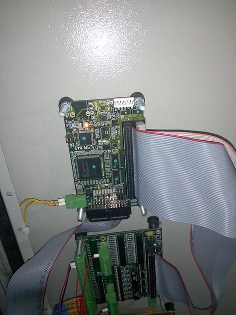

Hi folks.
I had to reinstall the Debian in my PC, I was using an old version emc2 it was working fine with 7i43 mesa card.
I made a files backup, now I'm trying restart the system but it not works. I edited the files using pncconf. The emc is running normally, the problem is that all axes don't move. I tried axis tune, but it not works too. When I start axis tune, the firmware is loaded to the 7i43 card but it don't generate pulse and Dir to drive the motor.
What you think can be the problem?

Replied by PCW on topic New emc2 2.7.0 problems.
Rather than start fresh with pncconf, I would start with your original HAL and INI files
to keep the number of changes to a minimum

Replied by andradela on topic New emc2 2.7.0 problems.
I got it, I created a new pncconf and insert the some data used in the old version, now it works.
Thank you.
