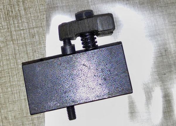

tool holder? It is manual, I put the cutting tool in the holder a tighten it down with a wrench. no quick change or nothing. I lose reference each time I loosen the cutting tool.

With a fully-manual tool holder you probably want to just use G54 (coordinate system) offsets all the time. For Z you can do this with a dowel pin, put the tool less than the pin dia from the end of the work then jog away until the pin slips through the gap.
X is probably best done with a touch then test cut method (very much like you would with a manual).
A quick-change toolholder might be a good investment, you are losing much of the advantage of CNC with that tool holder.
This is cute, but not what you would call cheap: www.ebay.co.uk/itm/152123879598
I don't know why the tool-point goes to zero if the DRO says not-zero. That's very strange, I have never seen it.

Yes, as you say the German one is "cute", although it's 57mm vs 70mm overall for the "Aa" size, so not a massive difference.

Its an Emco Compact 5, 5x14 that i converted to CNC, and yes I will be investing in a quick change tool post soon...
