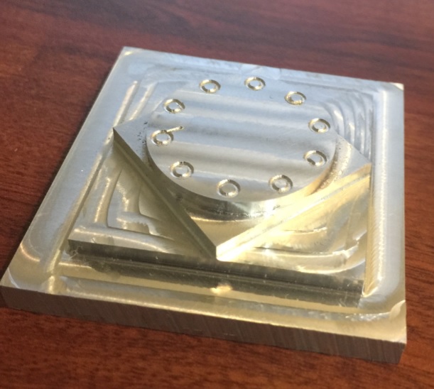

Here is my circle diamond square test.
You can see the little bump at the apex of the circle that I was talking about.
There is some tool deflection because I was trying some adaptive HSM tool paths and incrementally walking up the feed speed for each corner to see how they performed. This was cut with a long fluted 5/16 end mill with 1.6" of stick-out, depth of cut was .2 or .3" with a .2 max stopover so I knew that there would be some deflection.

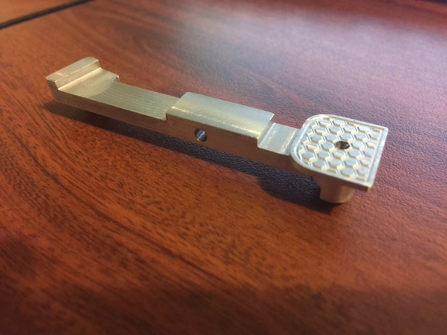

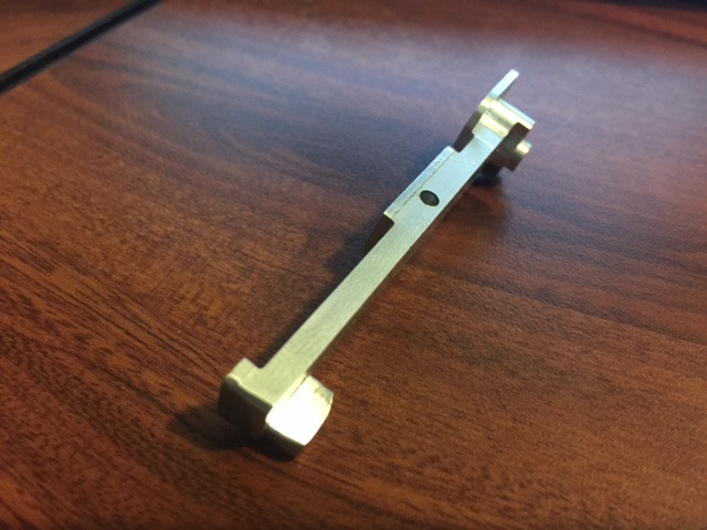

Here is the most recent part that I made, and you can see that there is a rotational offset between the two setups.

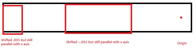

I will look again at my base period and see if I need to up the value a little bit. I did tweak it down until I stopped getting errors, but it is possible that it might be just a hair too low. I have made 3 of these identical parts, and they all turn out the exact same way. At first I thought that I did not set the origin correctly. Then after the second one I rechecked the vice and verified that it was aligned. The third one I checked and re-checked everything and spend 15 minutes perfectly positioning the origin. Exactly the same results.
In the part above, the roughing tool path was an adaptive clearing HSM tool path, then it was followed with a contour at final dimension. The origin was set to the hole drilled all the way through the part. The mismatch for the rectangular section is ~.002 all the way across, shifted only in the y axis. The angled part on the tip of the part was shifted about .005 only along the y axis, but again the face of the shifted part is parallel to the x axis. See picture below, kinda hard to explain.

If the axis or the vise were out of square the sides would not be parallel, but skewed the same as the pieces are out of place.
It really does seem more like a missing step problem. After running the part did (could) you recheck your origin point to make sure it had not shifted?
Changing the base thread speed likely won't effect it unless overruns are significant and/or step timing is marginal. I'd look more closely at things like increasing the step space timing, reducing max acceleration and velocity. Set the step timings for the longest times you need to reach your max feed rate, rather than the drives spec limits.
