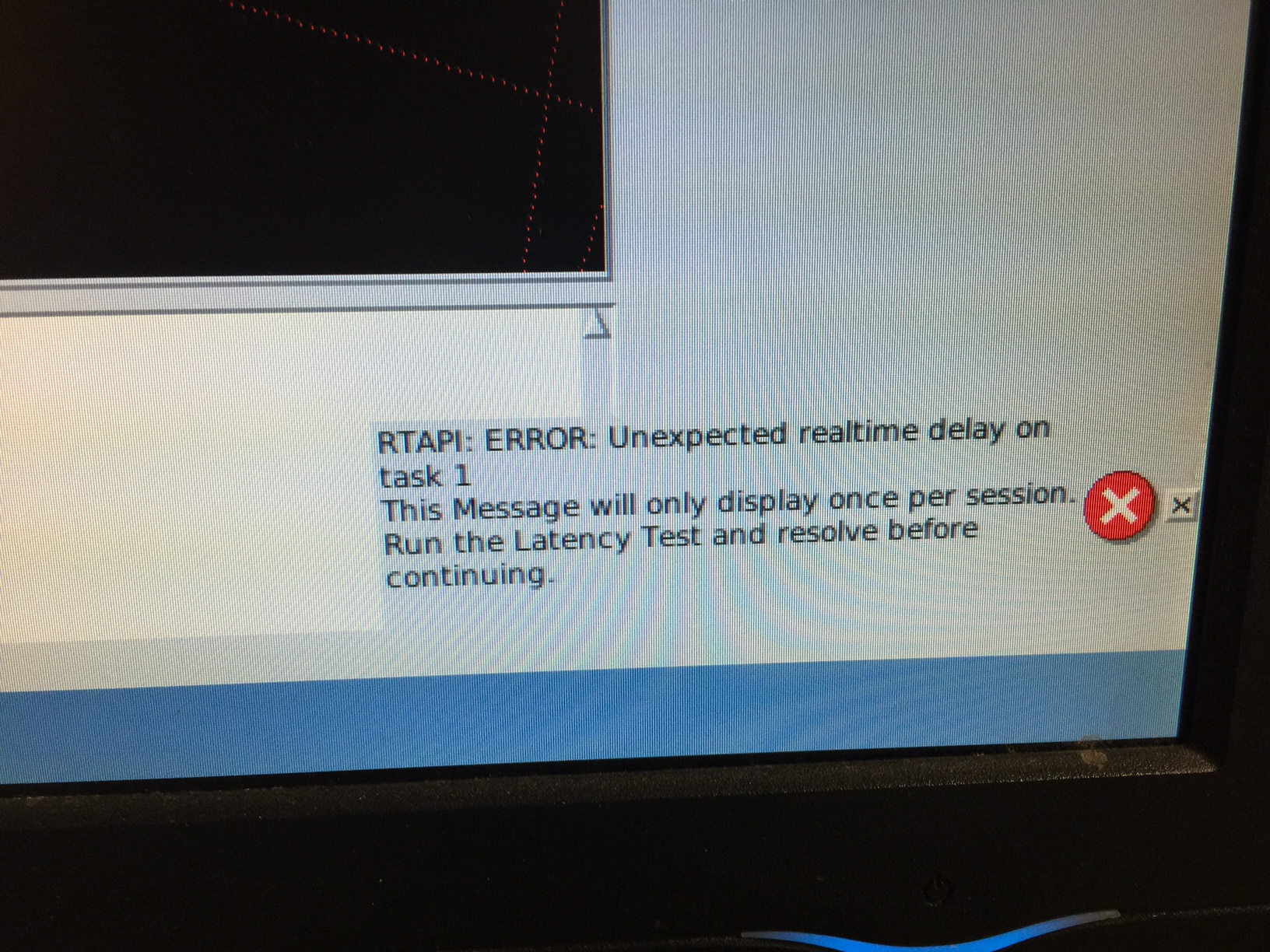

02 Jul 2016 02:54 #76912
by danimal300
Replied by danimal300 on topic Squaring machine / spindle
I set these values, and it seems to have helped. But I did get the error pictured below. I am still not sure what this is telling me. I increased the base period to 20000, and it happened again. The part I made turned out quite a bit better, so this must have had something to do with it. Thanks for the help.

by Rick G
Replied by Rick G on topic Squaring machine / spindle
Looks like you need to re run the latency test, be sure to load the computer with appropriate programs, such as running glxgears and run it for an extended period.
Rick G

02 Jul 2016 10:31 #76917
by BigJohnT
Replied by BigJohnT on topic Squaring machine / spindle
Open a terminal and run latency-histogram for a while.
JT
JT

03 Jul 2016 17:20 #76942
Replied by Todd Zuercher on topic Squaring machine / spindle
Only the base period timing (and to some extent servo period when latency is really bad) have any effect on the real time errors. The other timings only have to do with the step generation signals.
Increasing your base period time may not be the best answer to your real time alarm error. There may be settings that you can change for your system that could improve latency, fixing your real time alarm, and possibly allowing you to run a faster base thread. Have you turned off hyperthreading, and any power saving or wait states settings in the bios?

05 Jul 2016 16:09 #77042
The RTAPI error alarm means that the computer could not meet the time requirement for task 1 (probably the Base Period)
You can look at the actual base thread time while Linuxcnc is running with the hal pin "base-thread.time" and see the maximum time with the parameter "base-thread.tmax"
