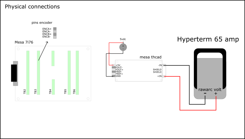

Hello I have a mesa 5i25 with mesa 7i76 doughter card and I am thinking of buying a mesa thcad for torch height control. I have read some post and manual but i can't realize how to wiring plasma cutter + thcad + 7i76.
what i don't realize is how to connect thcad out to encoder input.
FOUT-
FOUT+
FREF+
FREF-
I have attached a picture how I think to connect. plese let me know if I am wrong.
Thanks in advance.

FOUT+ to ENCA+
FOUT- to ENCA-
5V to 5V GND to GND
SHIELD to FRAME GND
FOUT- to ENCA-
5V to 5V GND to GND
SHIELD to FRAME GND
Last edit: 04 Jul 2016 18:13 by PCW. Reason: wrong connections

what about FOUT+ and FOUT - ?. should I have to left them unconnected?

Yep, not used

Oops ,sorry go that backwards
FREF+ and FREF - are not used FOUT+ and FOUT-

Ok I understand. thank you.
last question what mode should I use?
Encoder input mode: differential on single ended mode?
thanks.
thanks.

better to use differential mode
