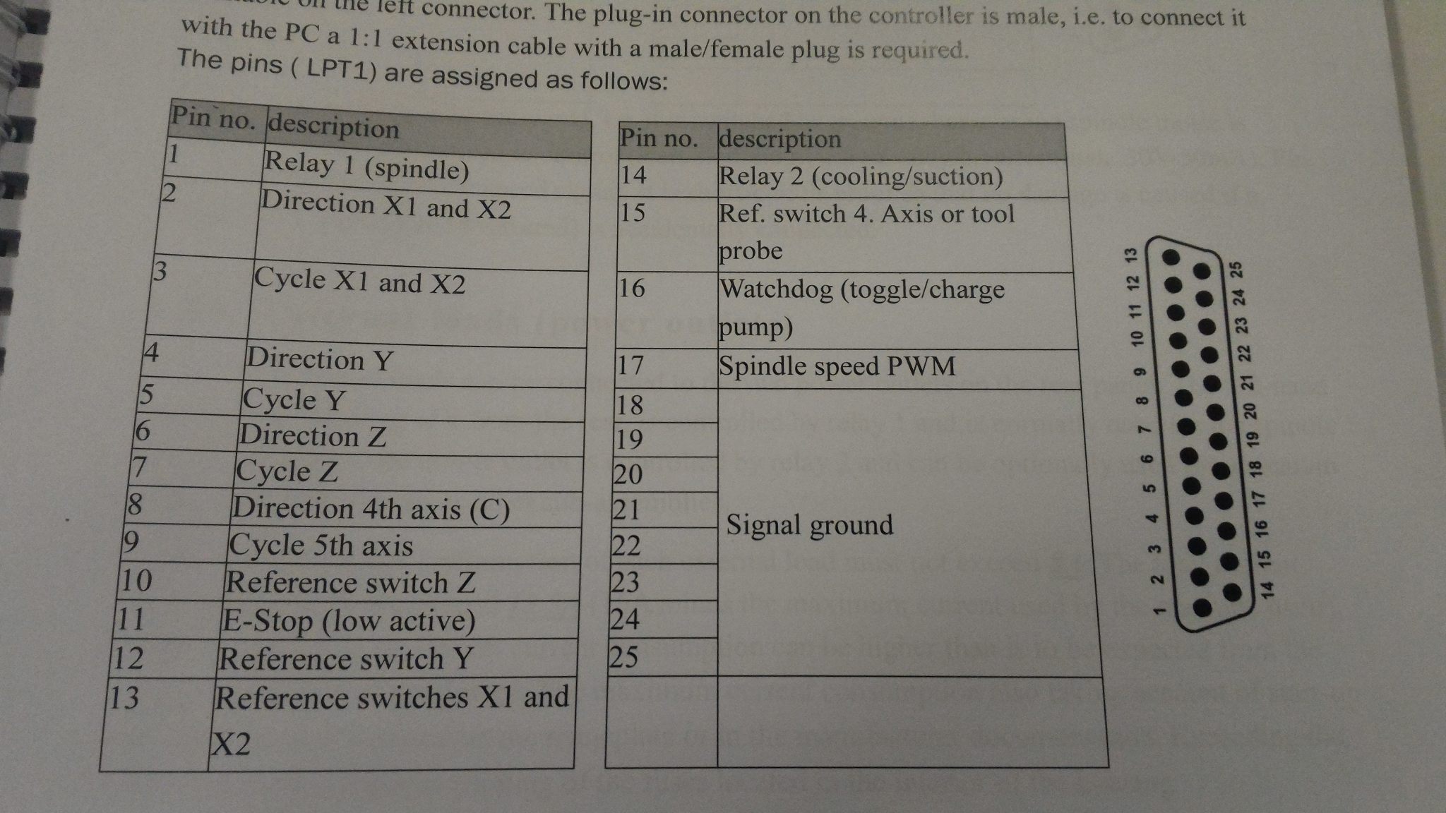

Hi
In my company we have a T-Rex S-1224 and we want to try the linux CNC. Here is the file with the pinout of the LPT port and the file with the configurations that we use on WinPC-nc. Can someone help me???

The file with the pinout and the configurations to winpc-ns.
