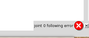

A first for me but I am sure the brains in here will know what I have done wrong.
Half way through a scratch and this comes up every time.
Push resume from next lineand it goes back to the begining and stops at same point again.
Frustrating.

You have "velocity" or "acceleration" set to high for X axis. Just lower it a bit and give it a try. Depending on setup and motors and weight of machine parts, a nice middle point is 60 for velocity and 200 to 300 for acceleration, if using metric, or 2 and 8 to 12 if using inches.
Please do check for the inches values as i do not use them, i just sort of calculated them.
This needs to be set in the .ini file, or in stepconfig if using it.

If it is a stepper machine read this:
linuxcnc.org/docs/2.7/html/config/steppe...html#_error_messages

Genius's both of you, many thanks.
Velocity was set at 1500 instead of 150, I pushed the zero twice and hadn't noticed it.
I had been playing with speed and got it up to 800 before it rattled itself of the bench.
