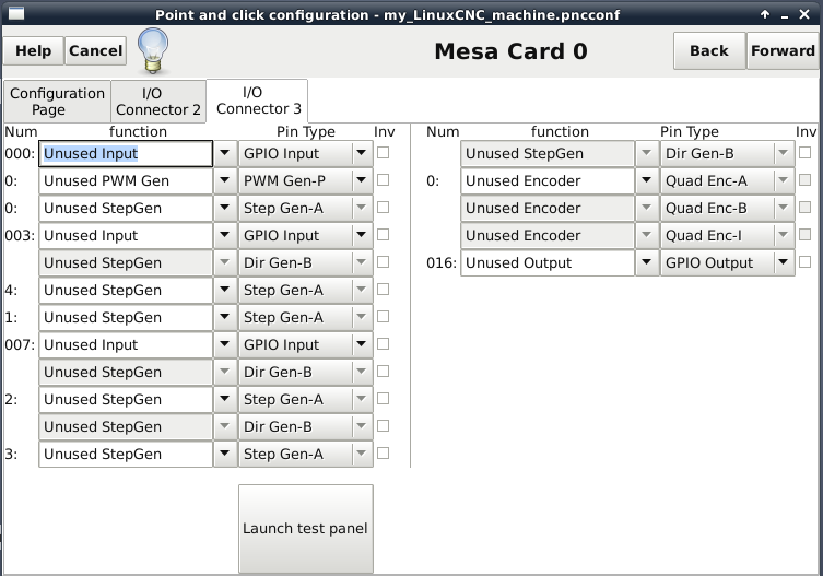

Thanks, that clears some of the confusion. I'll be working my way through what you have explained. I am sure I'll still have more questions about pncconf and what it's various terms translate to. I'm still not clear what pins they are referring to in the port configurations, they don't seem to have any correspondence to the G540. What file and subdirectory provides pncconf with it's screen options and information?

Most of the "pins" I have mentioned are HAL "pins" not physical pins on the 5i25 or G540.
In Pncconf try choosing the prob_rxf2 board as the firmware. The physical pin layout won't match the G540, so ignore that, but the actual config will end up looking identical, with the different pin-mappings being defined by the firmware.

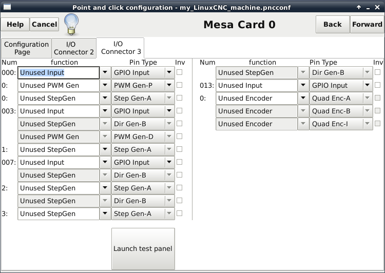

Is there any documentation or explanation that describes the relation ship between the numbers on the left hand side of these screenshots and the physical output pins of the DB25 (I/O Connection 3) on the 5i25? Perhaps a description that ties them into the
hal files or the ini? Does the halui: show pin or show param command give me the names of signals that are linked to physical pins?
Thanks things are a little clearer in terms of flow but still muddy is some details
05 Aug 2016 21:30 #78399 by PCW
Replied by PCW on topic Confusion-please enlighten
It looks like the numbers are instance numbers for PWM and stepgens, etc
(stepgen 0 is stepgen 0 regardless of what pins it uses) and GPIO numbers for GPIO pins
If you look at a .pin file that corresponds to your current bitfile, it gives the translation between
GPIO and physical pin numbers, and also shows which pins are connected internally to
stepgens, PWMgens etc.
