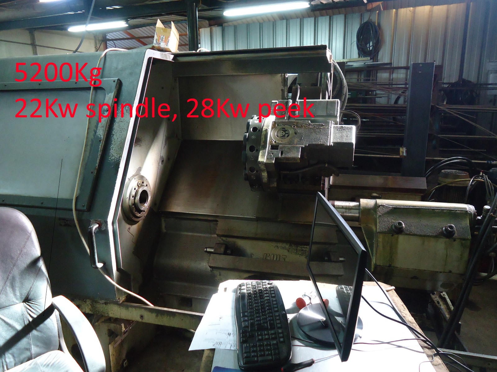

Chears,
Currently working on a retrofit of a large lathe. Until now we have X Z and spindle working. We are also able to move correctly the spindle in controlled fashion as the original drive (Siemens) have two modes: spindle or axis, so basically we are able to precisely "jog" the spindle to a position that we want, so very close from having a C axis.
However we are only able to do this with the spindle disconnected, this is, or we have a spindle on the configuration or a C axis. Why? Because when the spindle rotates the C axis is moving for a position that is not being commanded, so a following error pops out.
Would a mux be a solution? Or a better approach is recommended? Would like to receive recommendations before trying things that already have a solution for.
Maybe someone on the forum already have a C axis working? Do you know any? If so please step in or tell me who.
Thank you!

Not really, because whenever you activate the C-axis the machine will try to unwind every revolution that the spindle has done since power-up
You probably want to use the "orient" HAL component to give you an output for the PID that is only the fractional portion of the spindle position.
I would be tempted to just short-circuit the C-axis following error (net axis.C.motor-position-cmd => axis.C.motor-position-fb ) as a runaway of the spindle isn't really that much of a disaster.
