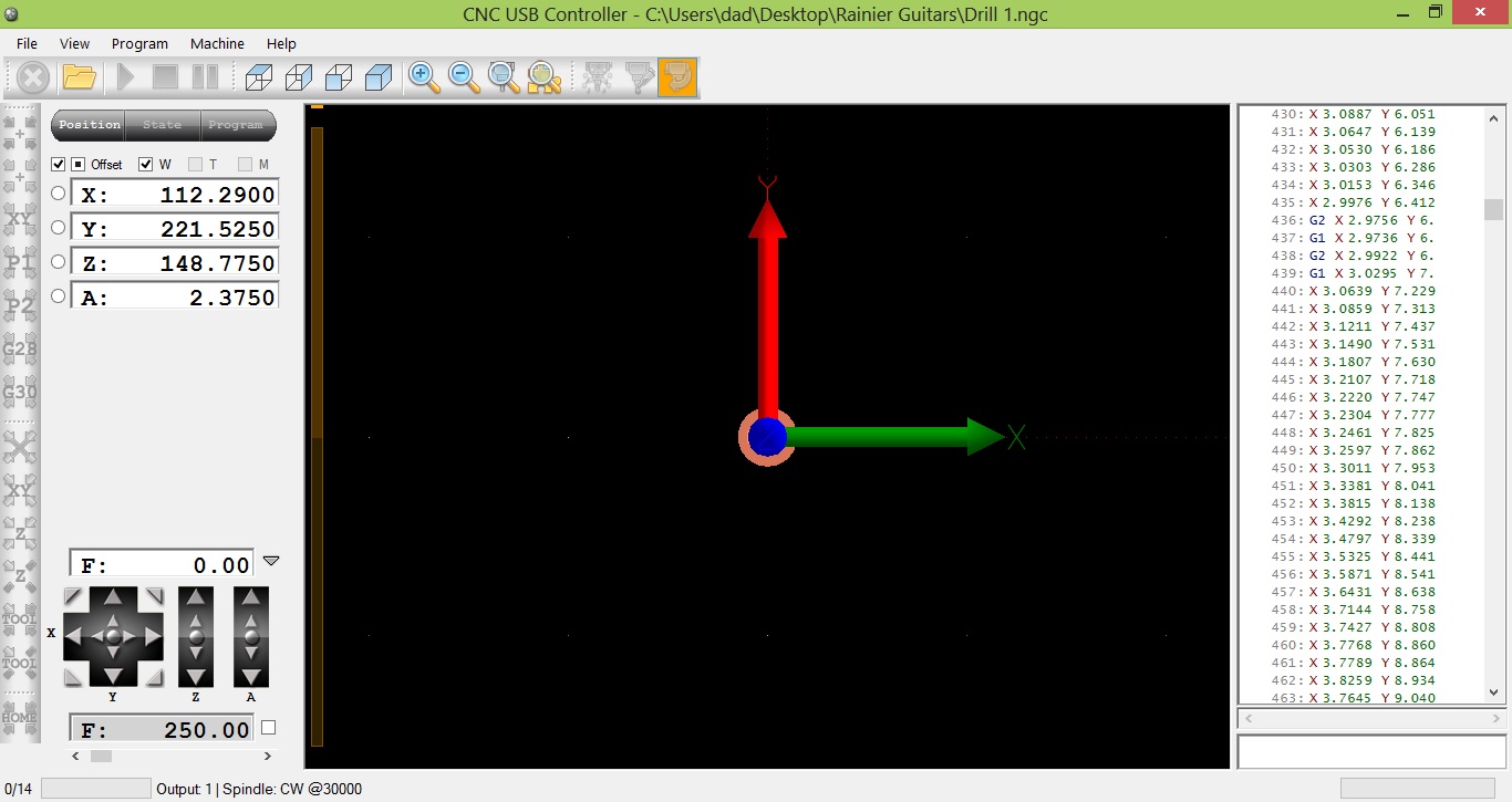

by Jena Lynn
New 3020T 3axis Router was created by Jena Lynn
It is made to work off a laptop, but my machines have no connection even though they are connected,lol. Steppers are on and hooked up to control box but no action yet. Thank you all.

04 Sep 2016 07:45 #80002
by Jena Lynn
Replied by Jena Lynn on topic New 3020T 3axis Router
Yes, it can work from USB or parallel port. My laptop runs it fro USB. I reloaded the software, programmed in Mastercam and it worked great. I will add this for anyone that may need help later, when I installed the step motors, they each have a screw that needs tightened, or the axis won't move. Thank you all.
